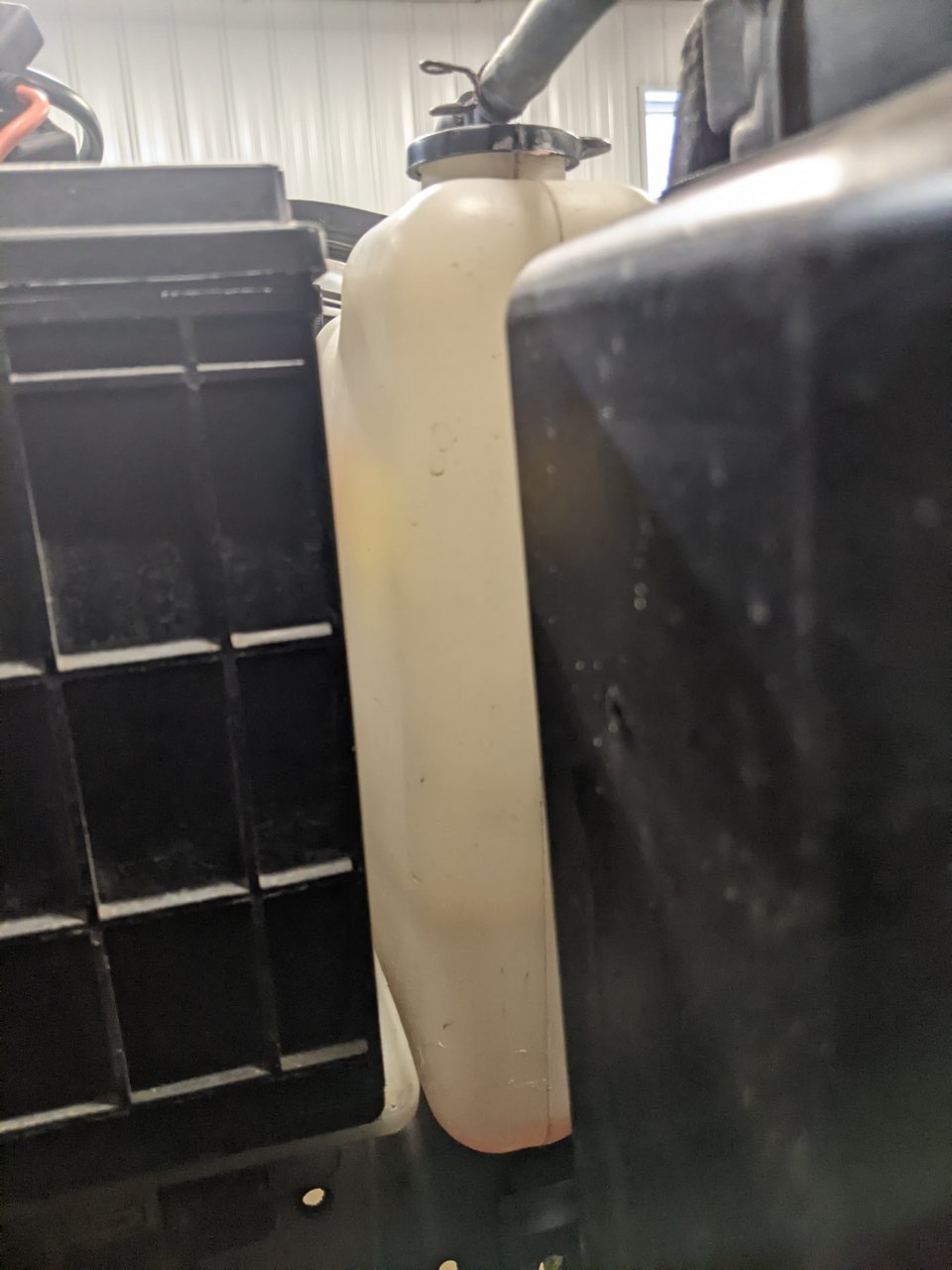

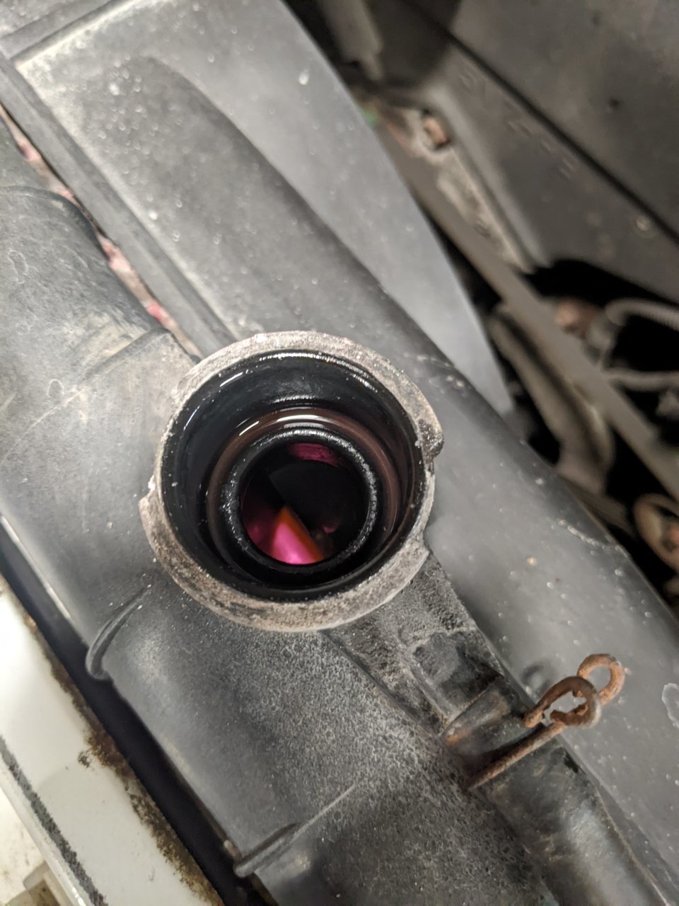

    So I realized my coolant is low by glancing at the reservoir. I don't seem to have any issues with overheating. I have some slight leaks evidenced by precipitated pink coolant on the radiator. Probably original coolant and radiator at 237,000 miles. Can I just fill the reservoir back up to the H mark with Toyota coolant or how should I go about getting the coolant level right? No experience with coolant or radiators etc.

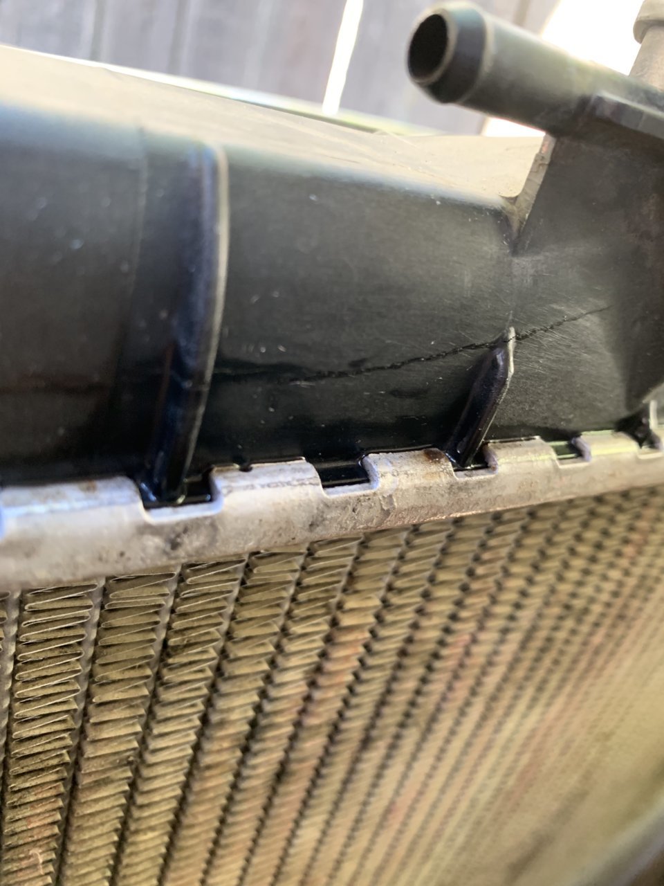

    Might have a crack in the radiator that only noticeably leaks when the engine is hot and the system is under pressure. I’d get it up to temp and then open the hood to look around with a flashlight if needed to spot any leaks.
    Mine developed a hairline crack right near the fill neck. Only leaked when pressurized.

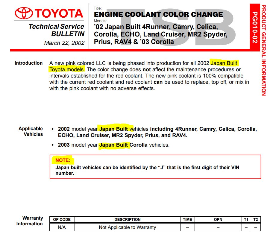

    So this is subjective I guess here on the forum. What I posted, I quoted straight from the FSM. The coolant mentioned and what you linked needs to be mixed. Mix it with distilled water - 50/50.
    When I drained my coolant and replaced it, I opted to use the Toyota pre-mix coolant. Can you mix the two? Hell, I don't know. I know @Empty_Lord has mentioned he's used the pre-mix coolant and hasn't had any issues. Others have as well. Some wont and stick with the one you linked.
    Something you'll just have to ask around about or make a judgement call.
    :notsure:

    Toyota pink premix is fine in any application.
    Worst case you have a crack as shown above, and you need to replace the radiator.
    Hour job at most, super easy.

    There is a TSB stating pink is interchangeable with red

    From that picture, at a minimum you need a new radiator cap, judging by all the dried pink coolant. Top off and check for leaks. If solved, consider doing a coolant drain and refill. If still leaking, replace radiator, check condition of radiator hoses (replace if soft or bulging) and replace coolant.

    Only one I was able to find is this one - weird how they seem to emphasize JAPAN BUILT.
    I used it and no issues yet.
    TWJLee and GilbertOz like this.

    just worded that way because the japanese models got it first. so for a while there was red and pink new.
    hell im running the pink coolant in my 1993 mr2 and the 95, 98 ,both 01s and the 02 tacos

    The 04 Tacoma apparently shipped with SLL pink too. 95.5-03 shipped with red. Just going off owners manuals. So SLL should be fine in all years.

    any replacement radiator ordered from toyota for any of the years will also say use SLLC on the sticker.
