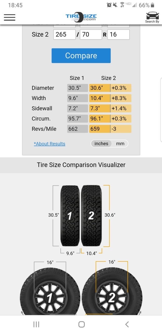

    According to this, they would be wider, but not much tallerScreenshot_20190825-184503_Chrome.jpg

    265/70 is ~the same diameter that you have now, just wider.
    If you want taller, go with 265/75 which will be wider and taller by about an inch.
    They will fit on a stock truck

    The ratio is in relation to width, so in this case the tire is still slightly taller, but not by much at all

    245/75R16 and 265/70R16 are same diameter and optioned as stock tires from the factory on 6lug trucks.
    If your truck is a pavement queen, and you arent going for looks (bigger tire like a 265/75R16), either size will do. Get some Michelin Defender LTX M/S's and you will have the absolute best tire money can buy.
