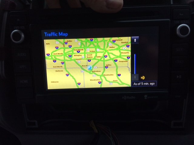

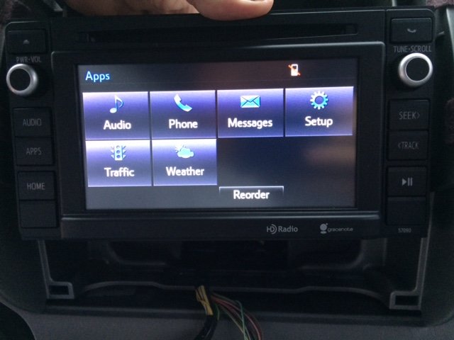

    I figured it out. I bought a second unit from a member here local to me and plugged it in a while ago and now have both Weather and Traffic. I don't have my time showing on the home screen but I am less worried about that.
    So maybe some Tacos did ship with Entunes Plus units that had no GPS antenna and left the factory with base model software? Good to know for guys out there buying these units. Just because it has an APPS button doesn't mean its configured as a Plus model.

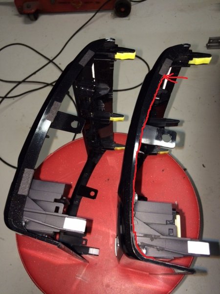

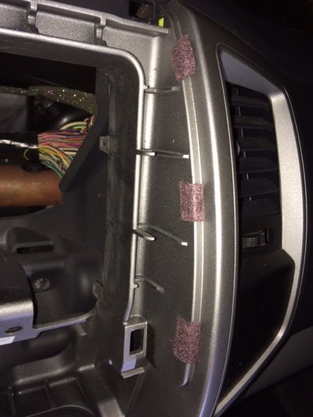

    Yeah, me too. Did you upgrade an early Tacoma like my 2007? I found that trimming the bezel instead of the dash was a much better option to get the Entunes radio bezel to snap into place. Was much easier doing it this way and retains the lip for the bezel to rest on. I did have to trim the two lowest guide tangs on either side in the dash opening as well. I added some stick-on felt since I lost four of the anti-squeak strips from the bezel trimming.
    Original bezel on the left, trimmed bezel on the right
