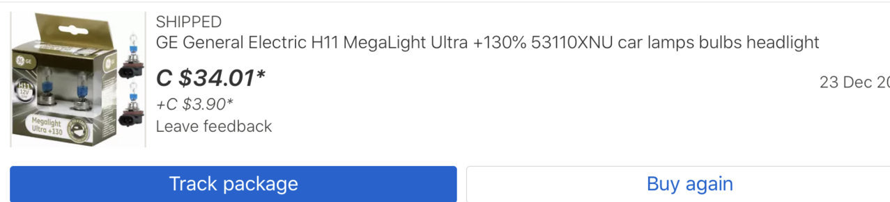

    brentc133
    brentc133 Member
    Dec 16, 2019
    #313496
    17
    2019 Tacoma TRD Sport DCLB Cement
    I decided to go with these and and very happy with the lighting improvement over stock. $35 well spent.C30C4146-0328-46DB-8457-9C52EEFBA5FD.jpg
    Hoff likes this.
  11. Jan 17, 2020 at 5:55 PM
    #31
    El Duderino
    El Duderino Obviously, you're not a golfer.
    Dec 29, 2015
    #173469
    12,928
    Jeremy
    HI->PNW
    19 nautical blue SR5 premium 4x4
    Stuff, things, this, an ADS
    I use this too. They work a lot better then the 150 dollar VLEDS I had installed. Wish crash made that thread a little sooner
    crashnburn80 and Hoff like this.
