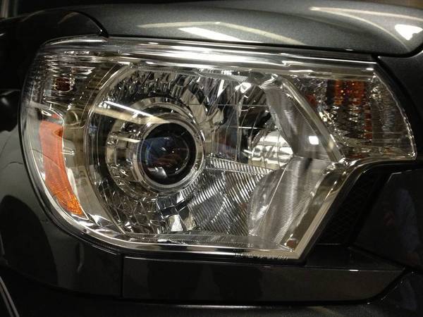

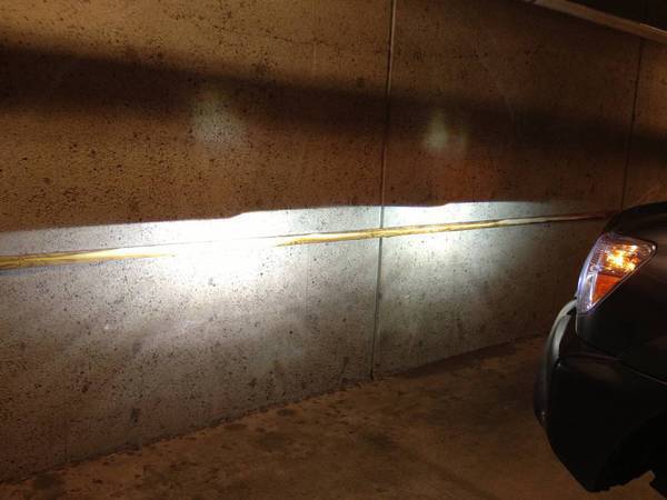

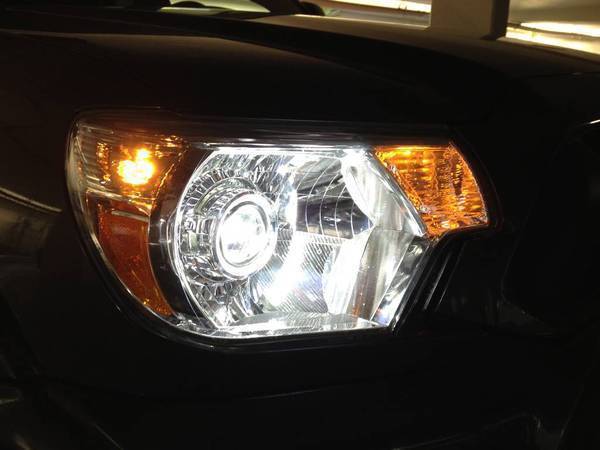

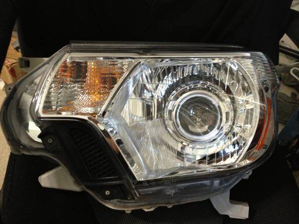

    Sorry I took so long to figure this technology stuff out....
    Morimoto d2s 5000k Apollo shrouds hide it well.
    No halo, black headlight mod. Everyone has their own taste, but I think the truck in the post above looks like an identity crisis. Like they really wanted a BMW, an older accord with blacked out shrouds, and watched fast and furious one too many times.
    I wanted the clean cutoff line, so I know how far to stop behind cars as not to blind them. Plus, throwing more light on the ground is always a plus. I think my truck looks weird with the retrofit, reminds me of a fish with beady eyes. I guess it'll take time to get used to it.
