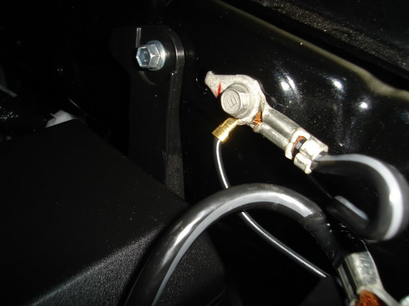

    This is where HIDs are grounded, is this not a good spot?

    I would think that was a fine place to ground it. So can you recap for me? Only the drivers side light works, you have switched the bulbs from side to side and the bulbs work fine. So the trouble lies, where? What can we eliminate?
