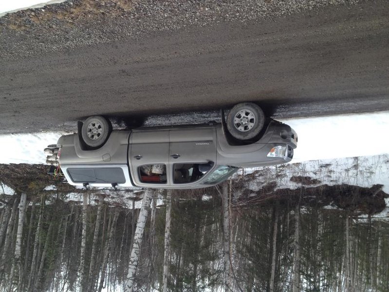

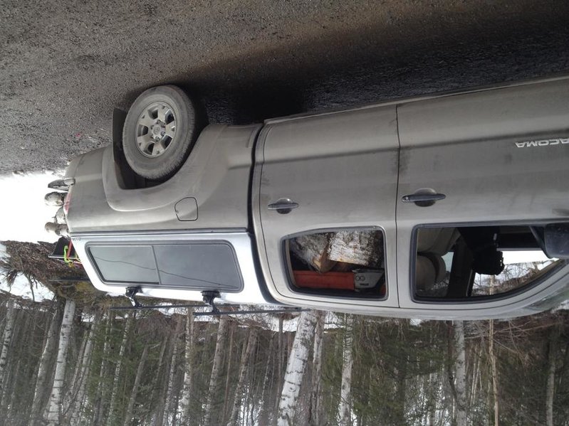

    Okay thanks for all the input. I failed to mention that my truck has these road master overload springs that were installed by a previous owner. They are supposed to help with driving under a heavy load. Not sure how effective they are. I think my solution is a combo of actions. 1 get a trailer. 2 install new shocks that it can adjust the pressure on. I'm told they are fairly cheap, easy to install, and effective. Ranchos? Supposed to have a lifetime warranty. Anyways I am loading a lot of green semi hardwood logs and really packing them in. I am not impressed with the tacos ability to hold the load in the suspension, but no issue power wise which gives me faith that I don't need a huge truck.

    Sorry to continue to beat up this thread. I decided to summon a little intelligence and take my truck to the scale at the dump after loading some logs. The scale measured at. 7550lbs. My truck weighs around 4100lbs so I was , to my complete surprise, carrying around 3400 in the bed of my truck. Minus gas and tools I probably had around 3200lbs. The truck handled fine, I was driving 55 on the hwy and looked down to realiZe I was at 65 at one moment with no issues. So my overloads are over, I thought I was hauling 1500 lbs at most. It's not even much wood in my opinion. Time for a suspension upgrade and a trailer.

    With all due respect, you are batshit crazy if you think 3200lbs of loaded weight in a 1/2 ton rated truck handles fine at any speed....
