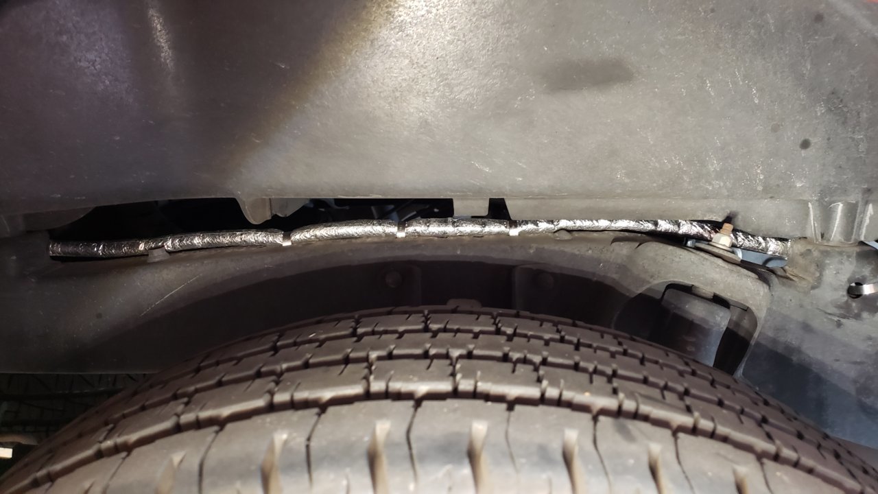

    Here it is on my 17, no passenger side harness, i just ran it accross the top and used the metal zip ties to attach to frame.
    I painted it flat back when i was done.
