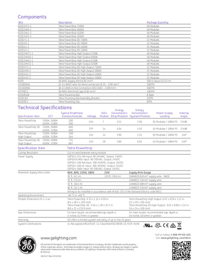

    I am a hand on type that can work with metal, wood, paint and a whole list of other things but I am straight retarded when it comes to electrical.
    I have these (see photos) LED lights that run on 24v left over from work. They’re really nice lights but I have no idea how I would go about wiring them behind the grill of my truck. Any help/suggestions are welcome.
