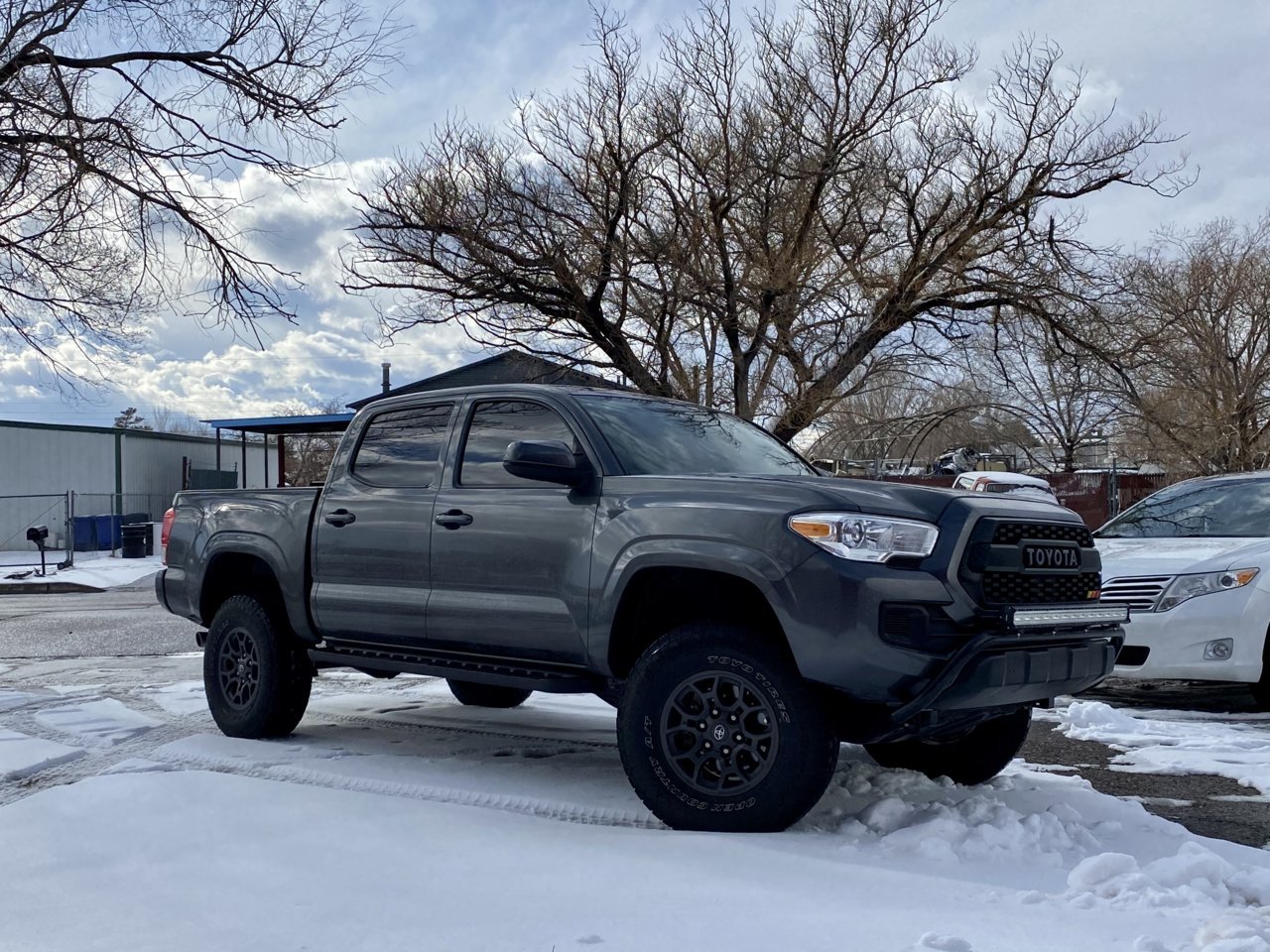

    UCAs for mid travel suspension are usually replaced to accommodate bigger tires, I replaced my UCAs to get caster, safely, to fit 285/70/17. This was pre alignment and you can see there is not much space from cab to tire, after alignment I didnt rub at all but I wanted some mudflaps back on to protect paint so I will have to heat up fender flare and flaps to fix minor rubbing. Also drive way is at an angle, truck is close to level with a little rear rake.

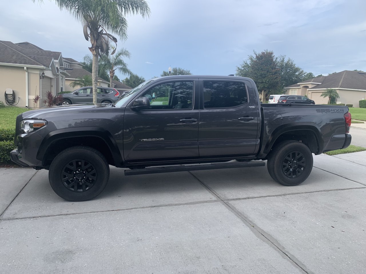

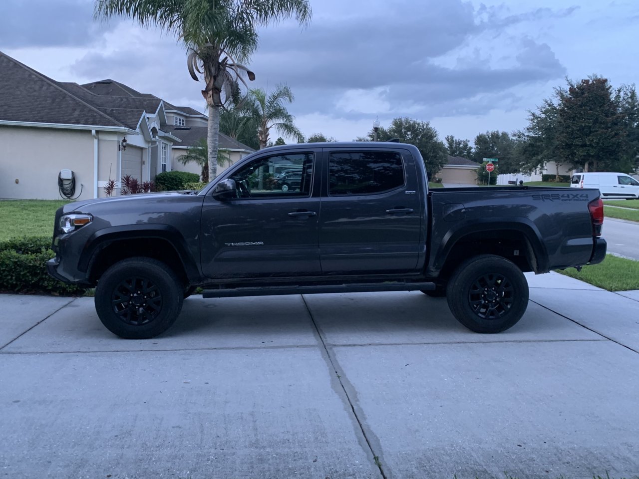

    Before8AC1DB54-8122-4A3B-8FFD-2A90BC502934.jpg after8AC1DB54-8122-4A3B-8FFD-2A90BC502934.jpg Finally got around to putting the 5100’s on this last weekend. Everything went really well. Set the front clip on the forth position up with stick springs and added the readylift AAL in the rear. I’m the very near future going to be putting the Eibach pro truck springs on the front. Overall gave me right at 2” of lift all around.
    measurements
    Measurements before lift were
    DF 34 3/4” PF 34 11/16
    DR 36 PR 36
    Initial measurements after lift came out to
    DF 37 PF 37
    DR 39 PR 39
    after about 40 miles of driving they settled in at
    DF 36 PF 36 1/2
    DR 39 PR 38 1/2
    Very pleased with the lift. Now just waiting for the new tires to come in. Went with the Falken Wildpeak AT3 in a 265/75/16.

    Thanks, will do. The picture on the bottom was the before and the one up top was the after. One of my friends did my truck looks like it skipped leg day with the lift and the factory tires. Thought that was pretty funny.
