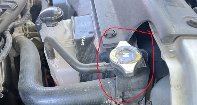

    How i check radiator
  8. Jun 21, 2025 at 7:48 PM
    pinktaco808
    pinktaco808 [OP] Hot Steppa
    Jul 23, 2010
    #40651
    4,703
    How i check coolant level in radiator
  9. Jun 21, 2025 at 7:52 PM
    Dm93
    Dm93 Test Don't Guess
    Mar 3, 2015
    #150066
    13,585
    Texas
    2014 DC OR 6spd 4x4
    Predator tube steps, Ranch Hand grill guard, Magnaflow CatBack exhaust, Toyota tool box & bed mat, 2LO Module by @Up2NoGood, Rearview Compass/Temp Mirror, Tune by @JustDSM.
    With the engine cold remove the radiator cap and see, it should be level full. Do not remove the cap with the engine hot.

    Take the radiator cap off

  16. Jun 21, 2025 at 8:29 PM

    It's called the coolant bypass pipe, it's below the power steering pump on the driver's side near where the radiator hose connects to the engine.
    The stock one is plastic and likes to leak.
    See the thread I linked above.

    Look like a pain in the ass to fix

    It's not bad with the right tools, need to see if it's leaking first though.
