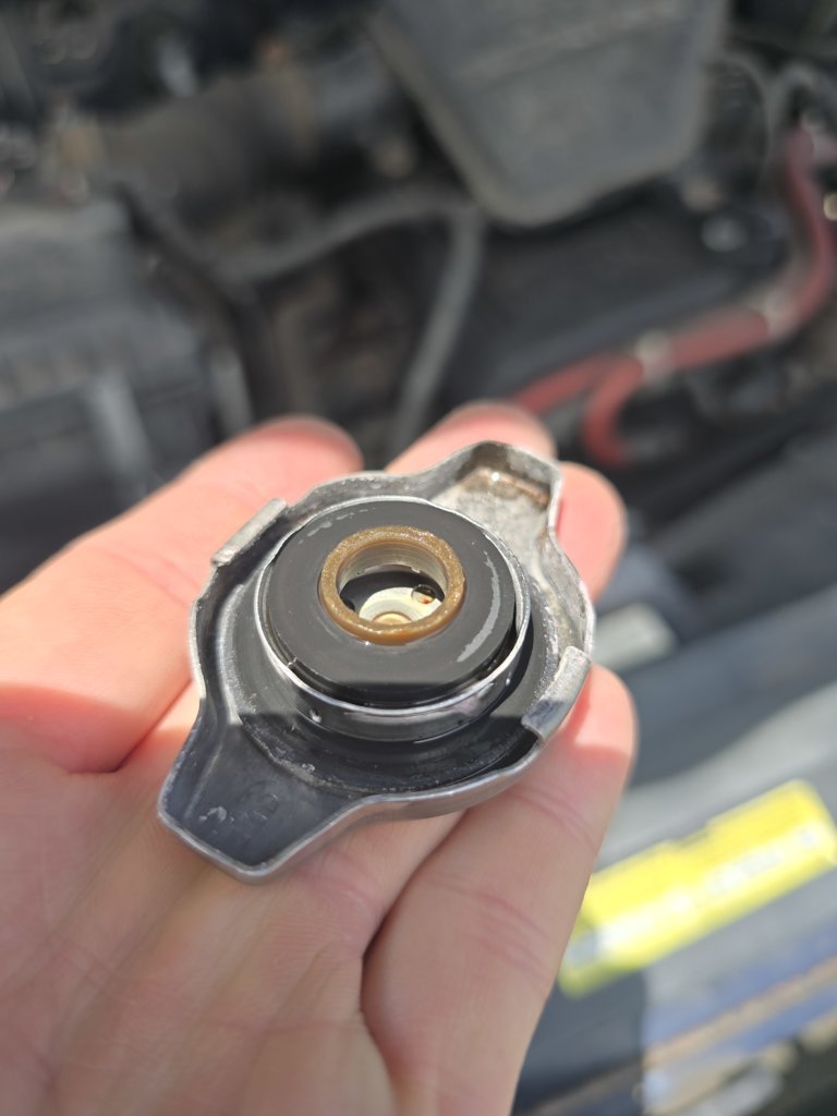

    Also how i know if have a bad radiator cap???

    Well it dark here and can't see anything I'll take a look tomorrow

    See if the rubber is good and that the little plastic check valve in the middle isn't missing.

    I think that the problem radiator cap missing check valve

    Is this okay???

    Nope it's missing the check valve, time for a new rad cap.
