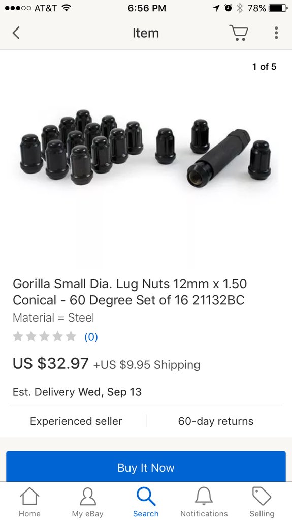

    I just bought some method double standard and I need aftermarket lug nuts. What kind of lug nuts did u get?

    Gorilla Nutz. I think they were 12 x 1.5 They were like these. But I didn't buy them for this price or vendor. Plus, obviously you need 24 lug nuts. Lol!

    Awesome thanks man!
