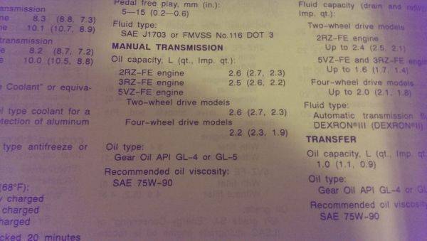

    My '97 2.7L manual states GL-4 or GL-5. I wonder if the trannies are that different between his '98 2.4L and mine. 2wd vs. 4wd maybe?

    I was just going over this yesterday with 97tacoNM and took this picture of my manual:
    I have read too not to use GL-5, but am beginning to question where that idea comes from in the first place.
    FWIW: I ran whatever cheap (think it was Valvoline) 75w-90 GL-5 in both diffs, transfer case, and transmission for over a year. Had no issues. Late this summer I swapped the transmission out to MT-90, it may have made a little difference, but not really a ton. At least not enough for me to notice any big improvement or anything else to justify the price.

    to clarify my 98 manual also states "GL-4 or GL-5".
