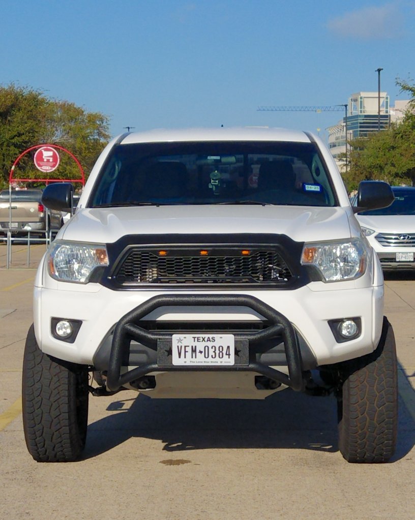

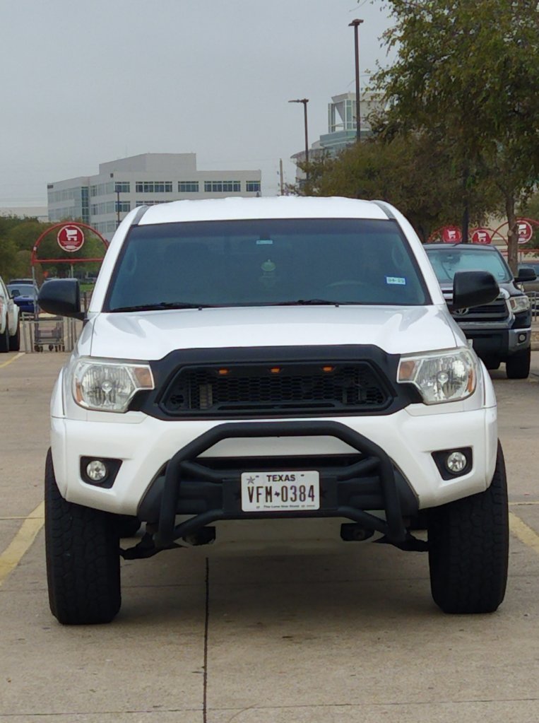

    Thanks for your reply, bro. Right now I have JBA UCAs but always when they do an alignment, it leaves the caster at about 3. something and the camber at -0.3, which I like the way it looks. I hate the positive camber on these tacomas. But it feels a little unstable on the road and loses a little power steering. I forgot to mention that I have Bilsteins 5100 and OME 883, which gives me 1.5” of lift. I understand that since the maxtrac's keep the original suspension geometry, it's almost as if I don't have that 4“ and maybe my 1.5” of lift with the OME 883's is not enough height for my JBA standard caster UCAs. I'm thinking of putting the original springs and UCAS on it, to bring it down to 4”. But I don't want to have too much positive camber or too low a caster. That's my problem!
    Without Maxtrac, stock ucas, Bilsteins at 0 and OME 883 Positive Camber 0.2 *
    Maxtrac lift, Bilsteins, 883, JBA ucas, negative Camber -0.3
