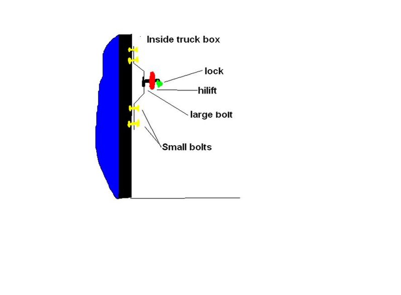

    JimBeam
    JimBeam BECAUSE INTERNETS!! Moderator
    Apr 14, 2008
    #5966
    52,079
    JB
    2015 Tundra
    you'll still need to put SOMETHING on the end of the bolt...like a nut...

  8. Dec 20, 2009 at 10:12 PM
    luk8272
    luk8272 Poodoo
    Feb 24, 2008
    #4929
    6,003
    Lucas
    Southern Louisiana
    07 Silver4dr. 4x4, V6 Shortbed
    5% Tint, Bug flector, vent Visors, Removed secondary air filter, Rear Spring TSB w/ Wheeler's Add A Leaf HD Pack, Icon 2.0 rear shocks, Toytec 3" lift up front with Total Chaos UCA's, Debadged, Billet Grille,TRD Offroad rims/17x9 Pro comp 6001 rims, Duratracs 265/75/16 or 285/70/17, Fog light anytime mod, Tailgate hose clamp mod, Pro-dry AFE filter. Extended Differential Breather, ABS on/off, 6000k LEDs from CSJumper, heads/fogs, ScanguageII, Devil horns, Devil horns on third brake light, Mounted 60" Highlift, Mounted Tool Box, Wet Okole Front/Rear Seat Covers, TW sticker, Midland Handheld CB,Painted engine cover, Revenge Fab Sliders, ARE Topper, Weather tech Floorliners, Camper shell, ultimate headlight upgrade. URD -3° exhaust cam gears, .5" XTP Intake spacer. Custom dents.
    What is the length of your jack? I have or had a 60" that I cut an inch off of to make it fit. I don't like removing parts then needing to find everything when I need the jack.

    hold on...ill try and draw a picture to help

  16. Dec 20, 2009 at 10:22 PM
    JimBeam
    Apr 14, 2008
    #5966
    52,079
    JB
    2015 Tundra
  17. Dec 20, 2009 at 10:23 PM
    luk8272
    luk8272 Poodoo
    Feb 24, 2008
    #4929
    6,003
    Lucas
    Southern Louisiana
    Where did you learn to draw like that? Its amazing.
    No really nice work.
  18. Dec 20, 2009 at 10:26 PM
    sandman427
    sandman427 [OP] KR FAB
    Mar 9, 2009
    #14497
    5,862
    Amir
    WAY THE HELL OUT THERE, So Cal
    BAMF TACO!!
    2 ten inch kicker cvt subs, pioneer deck and alpine 1000 watt class D amp, and flowmaster exhaust, 4 inch camburg lift spindles and my coilover is adjusted to 1" (5inch total) in front and 3" All Pro leafs, KING off road racing reservoir shocks and coil-overs, KR FAB CUSTOM BUMPER with three 9" HELLA 4000 Race LIGHTS , HID headlights with rigid amber LEDs , "KR Fabrication" custom built bumper, sliders and tiregate, Full size spare with matching rim, custom bed bar with two amber off road lights, cb radio, also BHLM (thanks Ray), and debagged
    ahhhhh finally that made all the sense... thanks tigerfan and all u guys for the help... i do appreciate it... what was attached to the small bolts...??
  19. Dec 20, 2009 at 10:26 PM
    JimBeam
    Apr 14, 2008
    #5966
    52,079
    JB
    2015 Tundra
    ms paint :anonymous:
