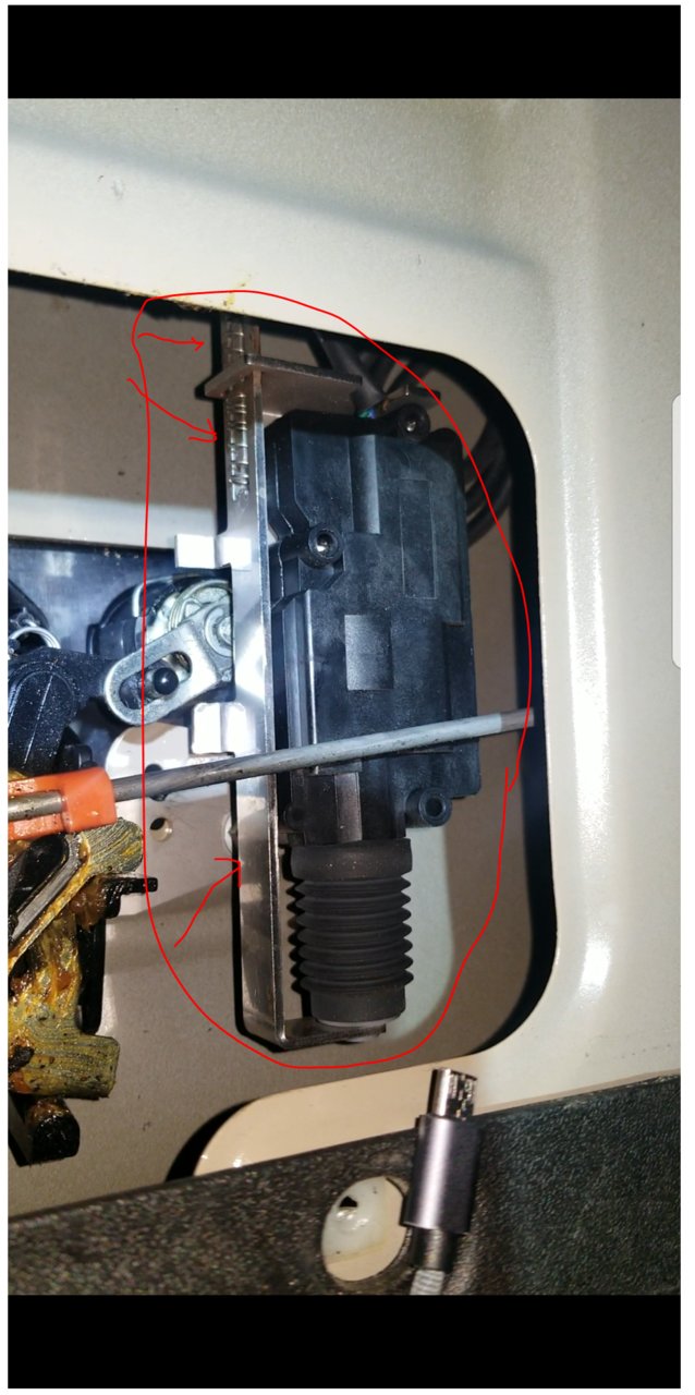

    I took off the tail gate rear panel and I see whats happening.

    Parts gave me this part 00016-34092-01 But I cant get it to pull up on google.
    The part below is a photo from my actual Truck on the part thats having issues.
    I am trying to figure out if I get the replacement part, how do I get the device to sinc up with my Key Fob. I am not a mechanic, but I can do some stuff.
    I circled the part that I need, but the arrows are pointing to the bar that vibrates back and forth terrible to make the noise Im hearing. Is there a way to fix it without replacing the unit?
    I dont know whats causing it to vibrate. All screws are tight, nothing is loose. I have a video but I cant get it to post on here of how it moves when its being locked & unlocked.
    The Aluminum bar (arrows) moves back and forth like a full auto like Brrrrrrrrp.
    Again, it still works but sounds like hell when I lock and unlock my truck But it does still work.
    Any help would be greatly appreciated.
    Thank you!

    A new actuator doesn’t “sync up” with your fob. The actuator relies on a wired signal from the truck when you lock/unlock. Remove the old actuator and replace with the new and it will work the same.
    Hopefully the issue lies with your actuator and not with any of the wiring. If its a wiring issue causing the unit to malfunction , the new actuator will do the same thing.
    The noise you hear is the actuator opening and closing rapidly, instead of just going 1x up or 1x down.
