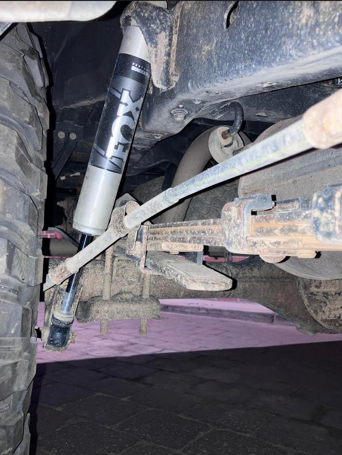

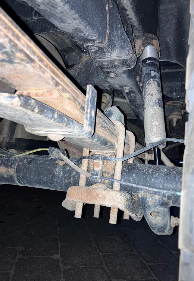

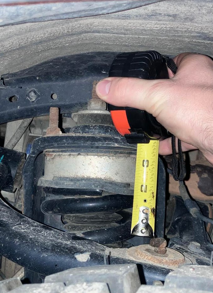

    Hey all,
    I bought a 2015 Tacoma about 6 months ago and have been building it since. I recently put 35s on (315/75/16), and would like to do a lift but am unsure how much its already currently lifted.
    The previous owner says that the truck has a leveling kit - 3 inches in the front and 2 inches in the rear, but... It doesn't really look that lifted to me. I dont see any AAL's or blocks in the rear and the leaf pack looks oem to me. In the front, the spacer measures to be only an inch - though I have read that due to suspension dynamics sometimes a spacer can produce more of a lift than it's width.
    When I took my truck in to get 35s mounted and a cmc the shop said it looks like it is stock ride height in the rear and 1 inch in the front.
    From the ground to the lip of the fender, the lift difference is about an inch. With my 35s, in the front I'm at about 39 inches and 40 in the rear.
    I'll post some pics here but curious to see what you all think. My goal is to lift it 2-2.5 inches all around with a leaf pack and coilovers.
    Thanks in advance

    Has lockers a skewp and a bit of droop
    Spacers in the front double. So that 1” spacer gives 2” lift. Looks like an aal was added to the leaf pack, so that has you at 2 in the front and 1 in the rear
