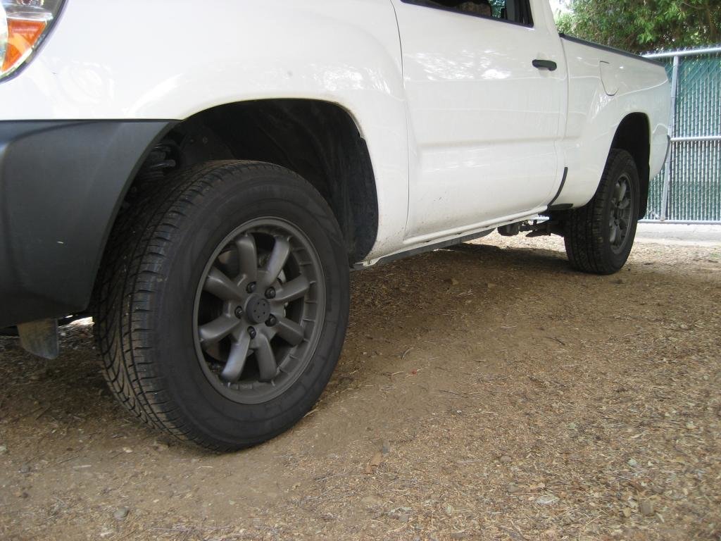

    Hi Ross,
    Welcome to TW. :wave:
    Sorry, I don't know anything about lifts, but I do know that putting really large wheels on your 5 lug is going to raise the gearing enough kill the power of your 2.7. Mine came with 245/75 tires on 16 inch steel Tundra wheels, and it was so sluggish and slow. It took excessive clutch slipping to get it moving, it bucked going up steep hills, and I could drive it on the freeway in third gear. When I put tires and rims (235/60/16) to match the stock wheel diameter (215/70/15) it came back to life again. :)
    Greg

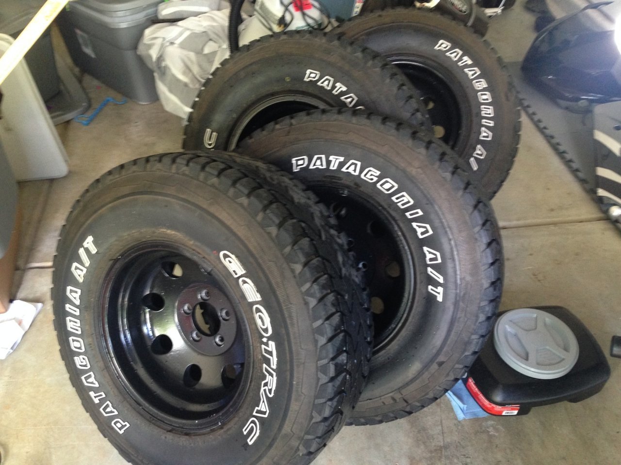

    Okay so its going down sometime this week or early next week, going to end up putting the lift on with new tires and rims!
    31x10.50x15 Geotrac A/T Tires with American Eagle Alcoa Wheels.
    I did have a question though, about the black boxes on Tacomas. I drive a 2012 5 Lug Access Cab, does my truck have those black boxes and if so how exactly do I remove them to be sure my tires don't rub?

    I believe it's a couple hundred dollars or something to recalibrate. I use gps for speed.
  20. Jul 22, 2014 at 7:49 PM
    #20
    Skinny Rogers
    Skinny Rogers U know fish can hear u thinking just b4 u sneeze
    Jan 5, 2013
    #94479
    847
    Lance
    NC
    10 taco
    Yes ur truck has them. They r where ur front mud flaps would b. there r write ups on here how to remove. It's a very easy mod.
