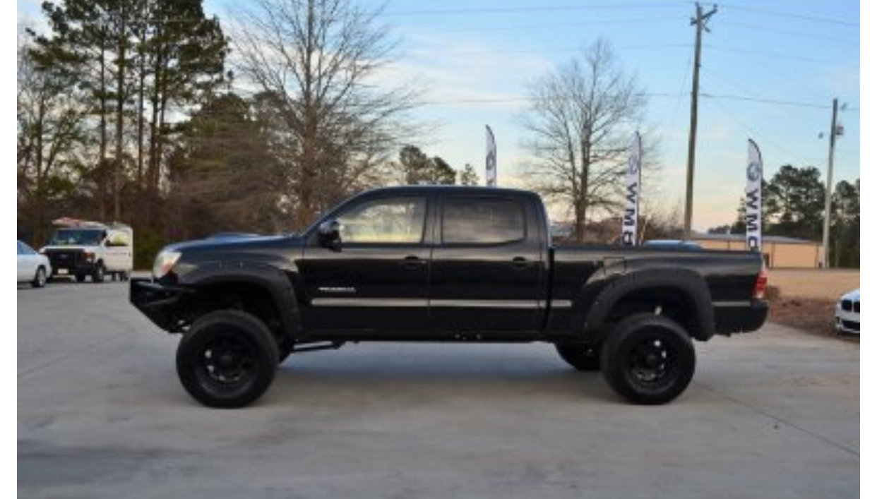

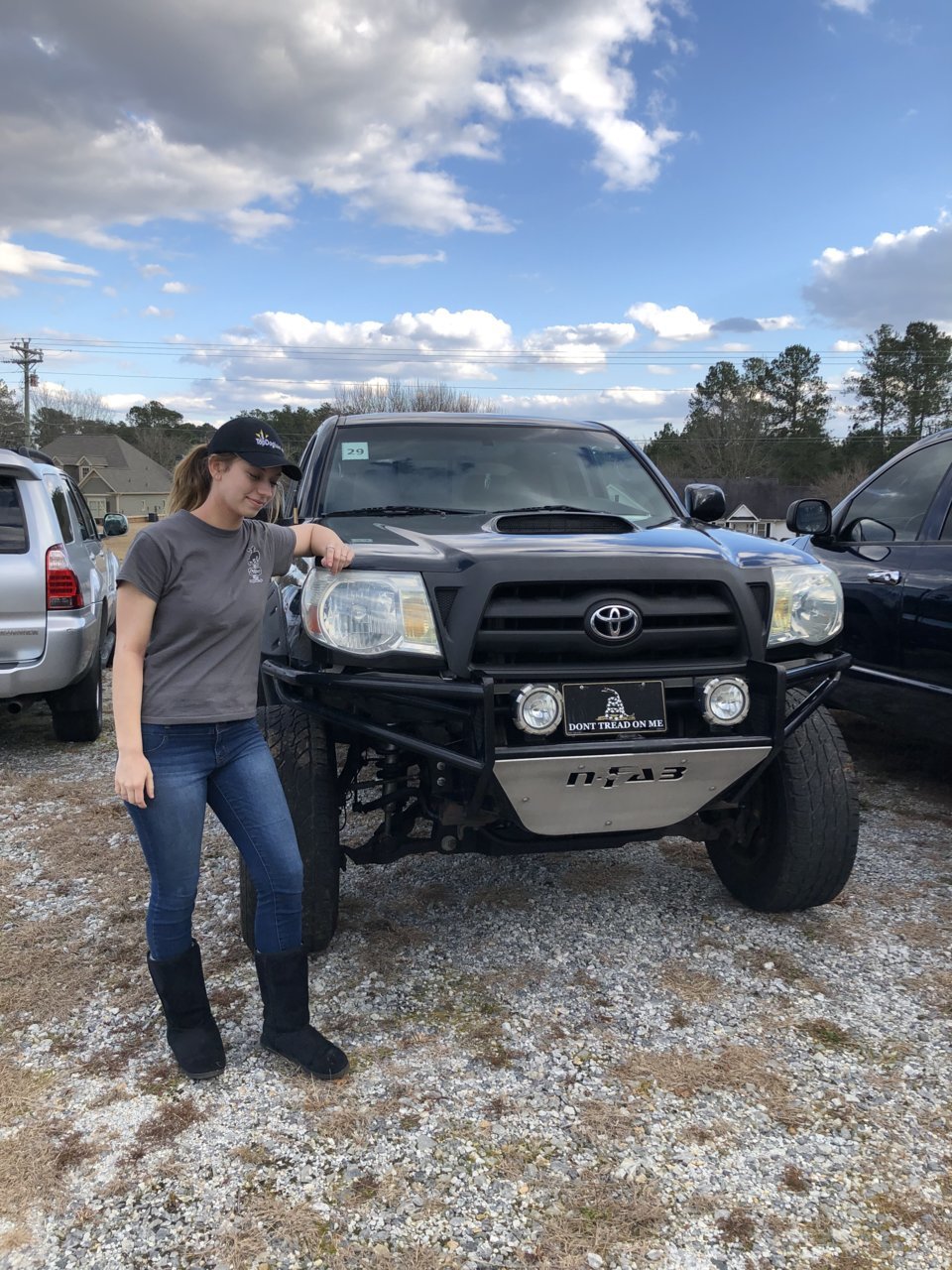

    Question... Does anyone have an estimate for what size these tires are from the pic? I included a pic of me standing next to it for size, I’m 5’7.

    Look at the sidewall of the tire and it should tell you something like 265/75 or 31x10.50 ... look for those kinds of numbers.

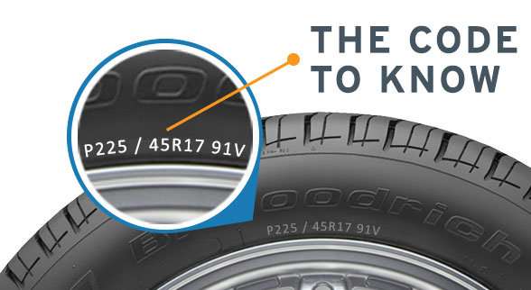

    Btw, the last number, for example 15, 16, 17... is the "wheel size". The pic is just an example of what you might see. In your case, you may see "LT" (Light Truck rated) instead of a "P" (Passenger rated).
