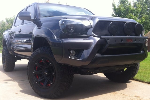

    Blacked out badges, Tinted Tail Lights, Fog Light Anytime Mod, Sock Monkey Bedside Decal, Painted Wheels, 20% Tint on Front Windows, 886 Bulb Backup Light Mod, Plasti Dip Rear Bumper (temporary until I get color matched), Color Matched Grill, Front Emblem, Door Handles, Mirrors, Bilstein 5100 all around, front set at 1.75, 1.5 aal, Crossfab light bar with 3 Hella Black Magic 500s, TRS Retrofit with D2S Projectors and Apollo Shrouds, BHLM with color matched Bowls and shrouds, CSJumper LED interior kit, CSJumper LED switchback DTRLs and Side Markers, 17x9 -12 Offset Ballistic Jester Wheels, 255x75x17 Nitto Trail Grapplers
    Jesters fit fine. A lot of guys on here run them.

    My wheels are 17x9 with a -12 offset (4.5 backspace) and my tires are 255/75/17.
    I'm running bilstein 5100s @1.75 up front and a 1.5 AAL in the rear. I had to remove the small flap at the front of the front fenders for clearance (I already had my mud flaps removed) I haven't had any issues with rubbing on road, very slight rubbing on the inner fender when turning right and the right front tire stuffed off road. Even with no lift you should be good with the stock tires.
    Choosing your offset will depend on a couple of factors. If you plan on ever running 285s or wider or you want a wider aggressive stance you need to go with the -12 offset. The negative to this is that you will lose some clearance at thefender liner/flares when turning.
    If you want to keep the stock look and are going to stay at a 265 width tire they are available in a +12 offset (5.5 backspace, the same as stock wheels).
    You can also get them with a 0 offset which is half way between the two above. This will give you a little more clearance at the UCA than the +12 offset and a little more clearance at the fender liners/flares than the -12 offset.
