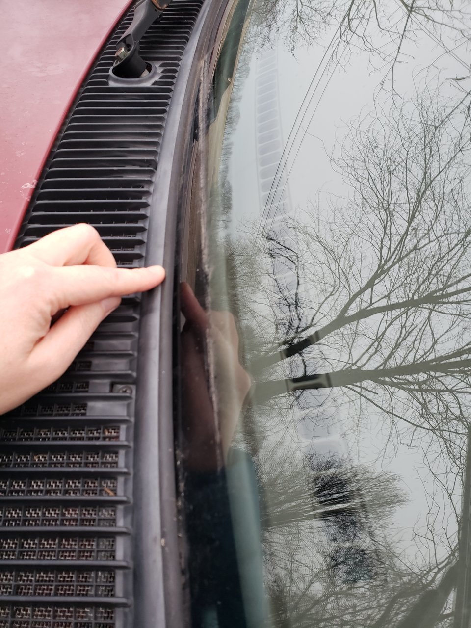

    This looked loose where I'm pointing. It felt loose. There's a small gap. Could this be it? Certainly sounds like the location. Is this testable? Should I try to shove something in the gap to see?

    I believe one of the issues described in another thread, or maybe someone posted earlier, was the windshield moulding. Again blue painters tape covering that seam and you'd know.
    To that effect, there is metal in that moulding I believe. Metal expands and contracts (of course, so does plastic & vinyl) so that could easily be it. If it is, some contractors grade silicone will fix it.
