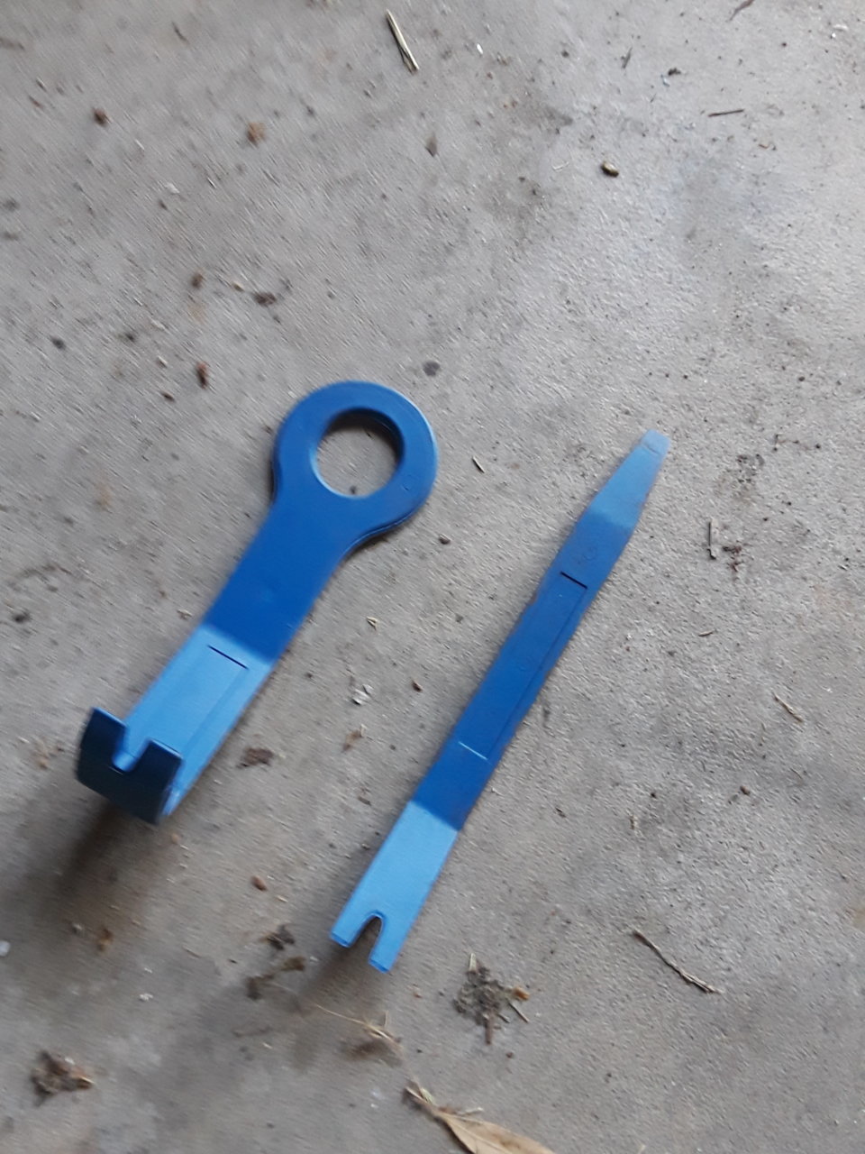

    I got all the screws out, but the handle and the window crank which as supposed to just pop out did not do so and the plastic started chipping and bending. I don't think I can get them off without breaking pieces which I'd rather not do. Is there a better tool for this job maybe? I was using flathead screw drivers.

    Do you have any auto panel removers? That is going to be the best bet, but you got to break a few eggs to make an omelet. 16427155349405008502813009021267.jpg

    I don't. I'll have to get some. Thanks.
    That's true. I know that will happen, but I'm quite fond of my omelet and didn't want to push it since I wasn't entirely sure I was doing it right. Also, the previous owner was a friend who passed away recently, so I'm slightly sentimental about maintaining its original condition it at the moment.

    There’s a spring clip that holds the window crank on, did you get that removed? There’s a special tool for it at the local auto parts store, or some people have had luck with wrapping a rag around (see YouTube)

    I didn't. I was looking for it cause I did see that in the videos I watched before I started. I was having trouble with it and the handle. I'm planning to pick up some tools and give it another try...probably not tonight in the dark and on the ice though.
