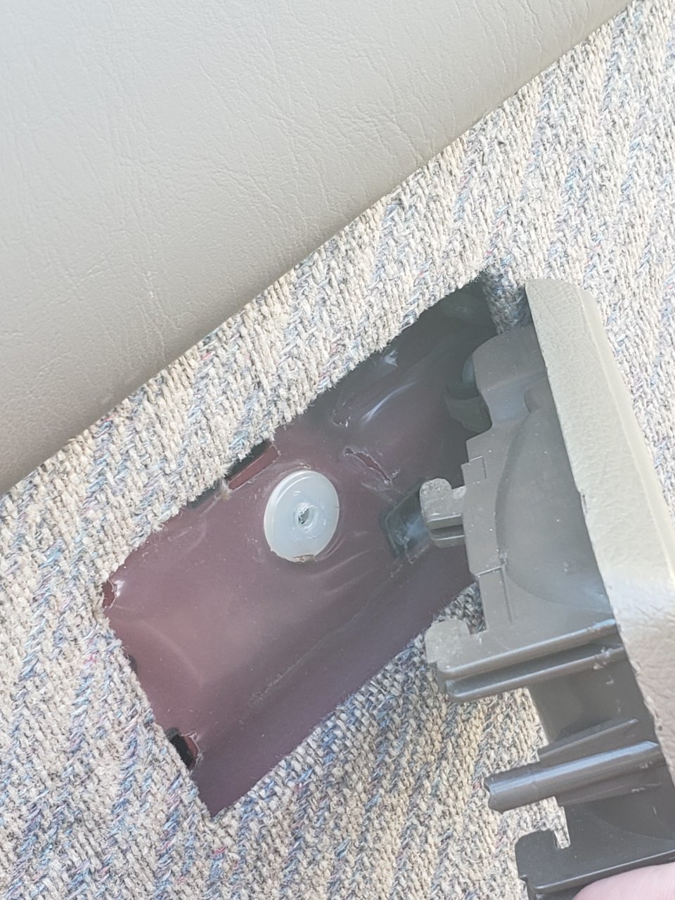

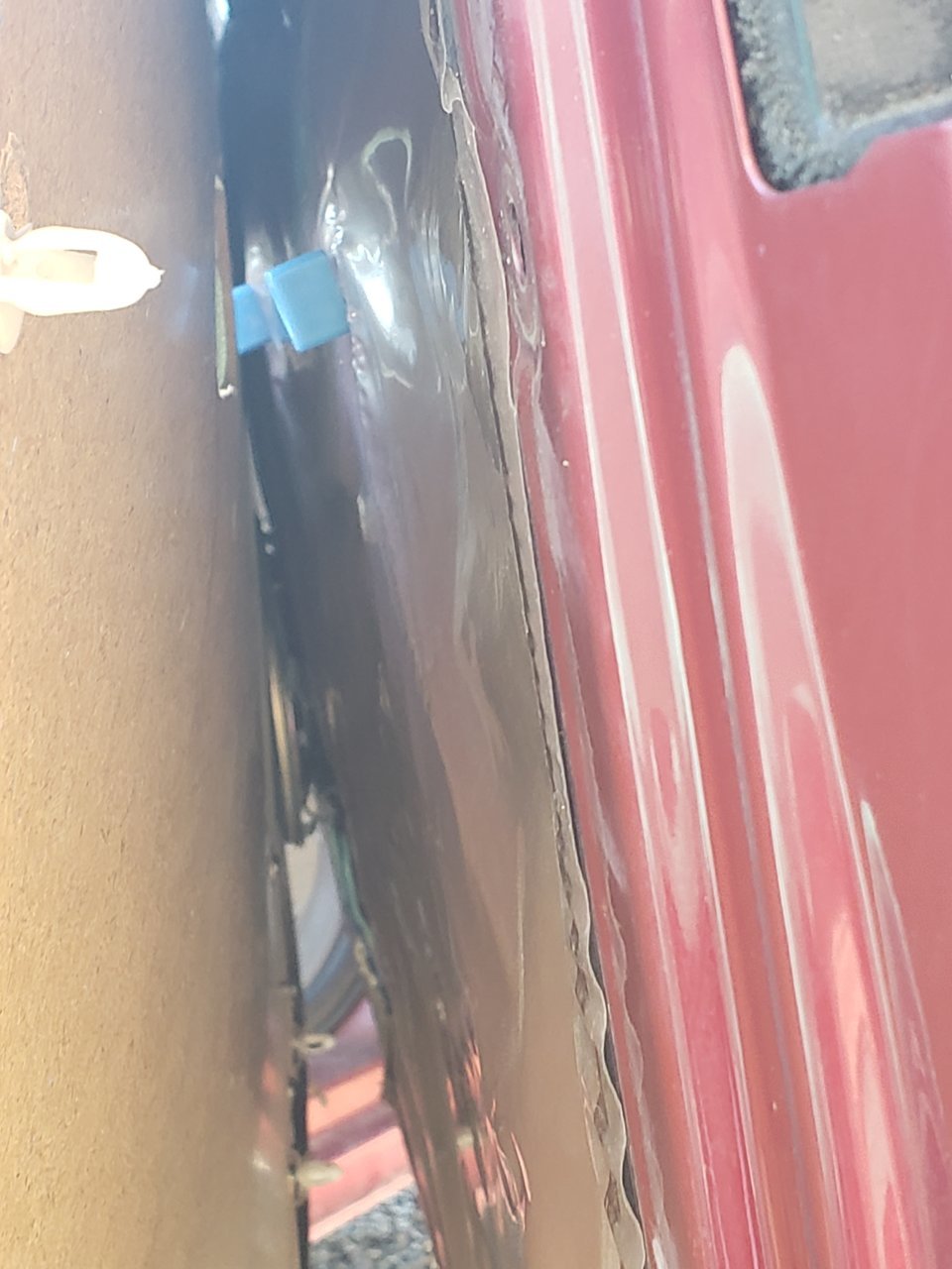

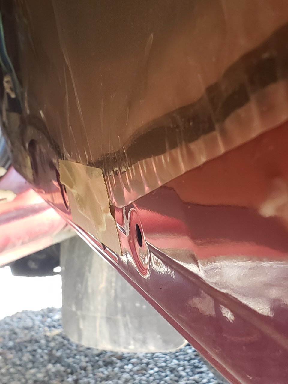

    I got the tools and made another go at it today. I got everything except that infernal clip on the window crank. I could move it back and forth but it would not release. After 30 minutes of trying, I ended up cursing at it. :angrygirl:
    I peaked back as much of the panel as I was able to see. Here's what I could see. Didn't see any tears except minor holes behind the handle, and there was some tape at the bottom.

    UPDATE:
    I think I've isolated the source to the windshield. I was driving with the noise going and just happened to need to clean the windshield. When I did and the windshield got wet with the wiper fluid, the noise stopped.

    What’s the seal look like? Might be just pushed out of place.

    Loose in some spots. Photo in earlier post.

    Yep. Planning to caulk this week when I get a chance so I can confirm this is it. :fingerscrossed:

    Yeah that does look suspicious, was looking at mine and it’s tight all the way across. A windshield shop might be able to get that all fixed up if caulk doesn’t do it. they’d probably just pull the whole windshield and put it back in as if they’d replaced it.
