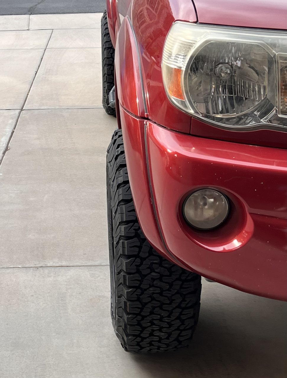

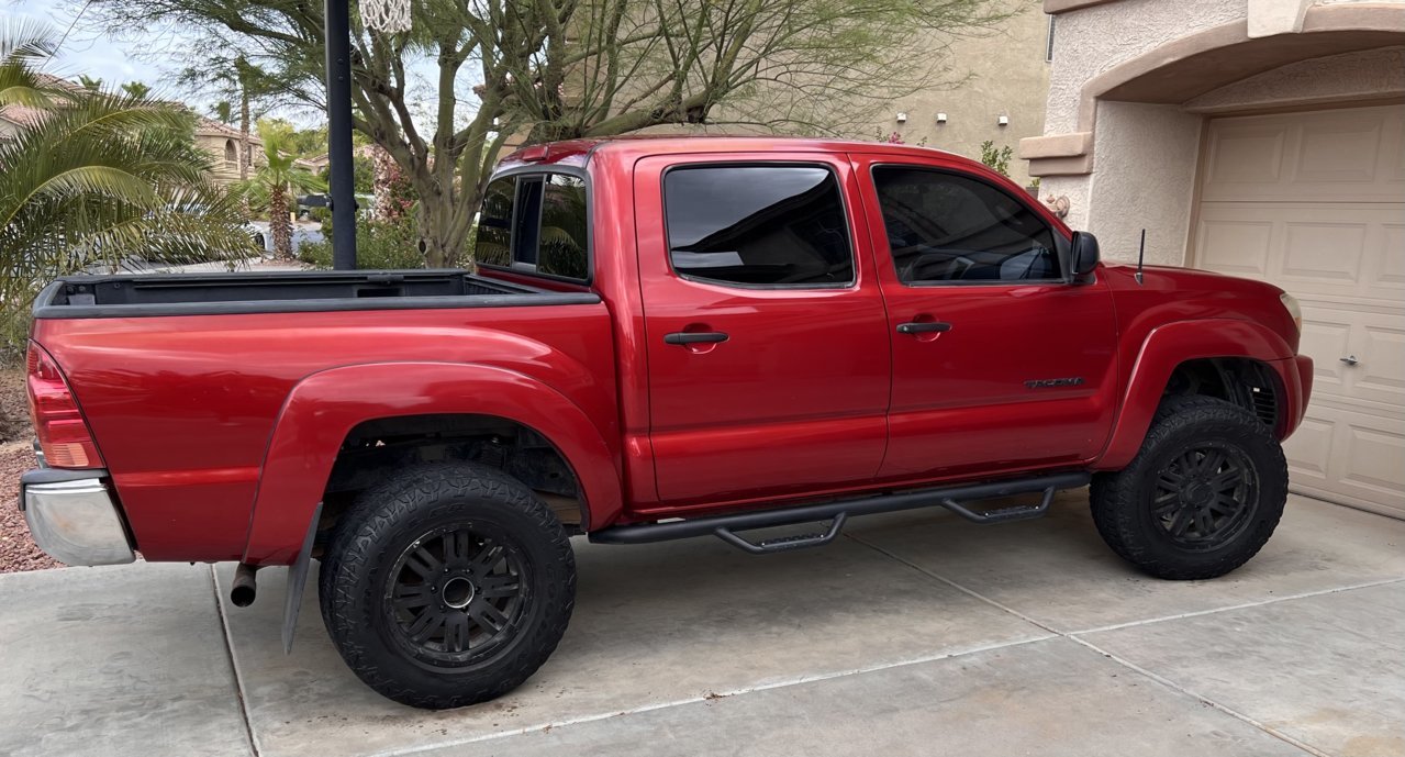

    So I got the American Racing Baja with the -12 offset and the 265/70R17 BFG KO2’s. Couldn’t be happier. No rubbing and the tires are much quieter than the Goodyear Wranglers. Wheel specs 17X9, 6-139.7 lug

    Looks great man! Glad to hear it worked out!

    is this stock height?
