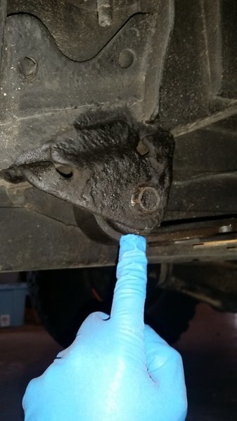

    Just saw your post 6 years later...but im having the same problem just wondering what you did to fix this my truck is the 2002 tacoma double cab and im running the dakar leafs i thought something bad was happening in the front of the truck but when we shake the truck side to side the front eye of the spring slides back and forth inside of the eye that wraps around it... i dont think anything will ever break but its very loud....20160518_103530.jpg
