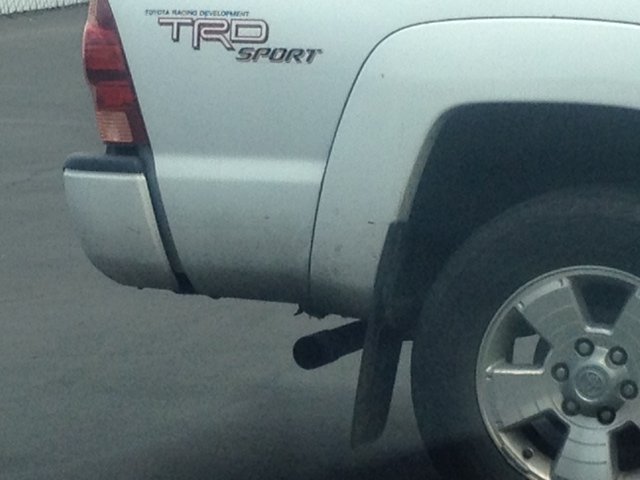

    Op, just curious. Is your exhaust tip and bedside all sooty like a diesel?
    I snapped this photo at my supplier the other day. (Not my truck) but what looks to be an '05-'06ish TRD-Sport. The bedside near the exhaust tip had a noticeable layer of soot, and the exhaust tip was fairly black and covered with soot around it as well.
    My 2010, V6, Double Cab, exhaust tip is squeaky clean inside and out (you could probably eat out of it), and I don't clean it when I wash the truck. Mine has 58K miles on it, so I was wondering if the black sooty exhaust I see on most V6 Tacomas, is the sign the cats are failing, or O2 sensors are starting to give an incorrect reading?

    How often do you wash it? It's possible you have one with A perfect factory tune also.

    With two small kids, wife and pretty much work six days a week, I wash it when it rains or run it through the touchless at the gas station every two, weeks or so. I know that sounds like I'm neglecting my truck, but at my life stage I really don't have time to spend 2-3 hours detailing my vehicles in my driveway, as I did in my early 20s.

    That is nearly not enough time to gather up soot and stuff on and around the tailpipe area. Some people neglect washing their truck for weeks. That is why you see so much. You gotta remember that most of us have the drive it filthy mentality when it comes to owning these trucks. I go 2 months or more without washing her, but when I do. Soot comes right off and doesn't return for a long long time.
