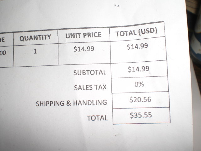

    And cheap too.....
    Well.....sorta.....

    Def not what I paid. We're about to find out if it doesn't stop raining soon ill put it tomorrow

    Out here now got new one on. How tight????
  5. Feb 25, 2023 at 5:04 PM
    #25
    Levisbustedtacoma
    Levisbustedtacoma Well-Known Member
    Nov 29, 2022
    #411877
    212
    Levi
    01 4x4 extracab
    Bilstien 5100s eibach coils Dakar leafs Chinese balljoints
    33ft lbs. Anyway got it done. No cel after several miles and a complete drive cycle for the obd. Timing is back to 12 degrees at 702rpm idle. Fuel trims are close enough to zero for me and drives fantastic
