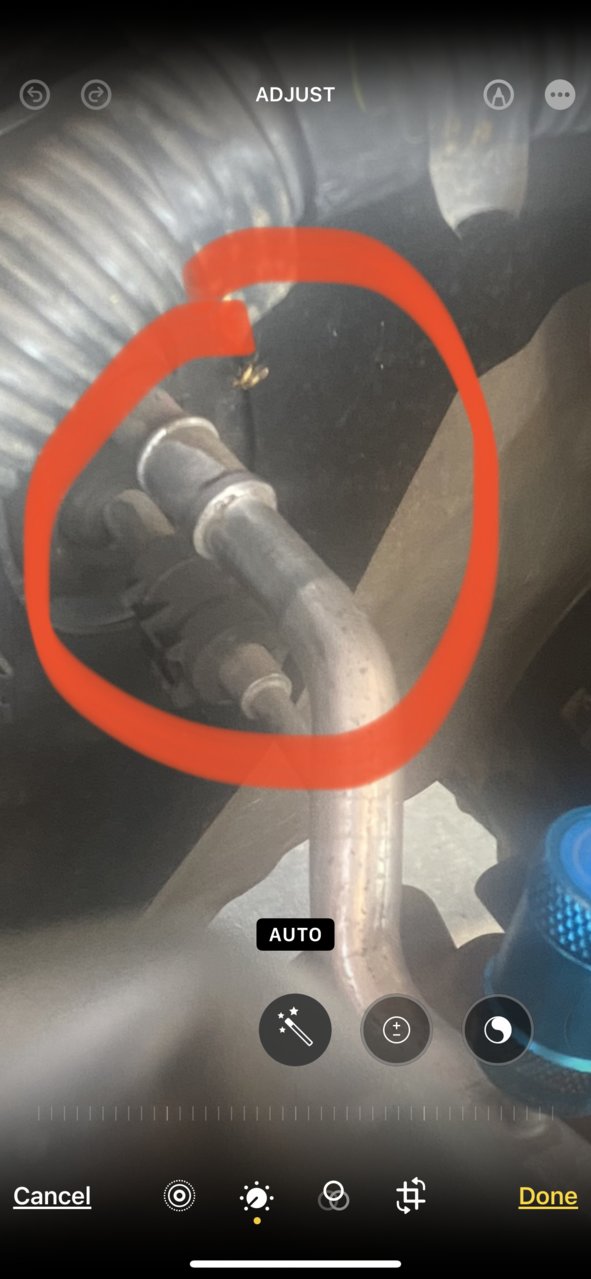

    Hey guys. New member here. Got a question. I need a AC line clamp and cannot find a good exploded diagram to reference. Hoping someone here can help identify
    the clamp I need is from the upper hard AC line coming out of the firewall on the passenger side. Make is 2017 Tacoma 2.7l 4x4. I’ve included a picture of the area the clamp should be. Any help would be greatly appreciated

    That is not a clamp. That's a coupling. You won't be able to replace it yourself unless you're experienced with aluminum refrigeration piping

    I cannot imagine what happened that you need to replace that coupling but you need a professional for the refrigerant.

    Thanks for the responses. The truck has been in accident previously to my owner ship. That wreck damaged the compressor. I’m not sure how it is missing this clamp but when at the AC shop having the new compressor put in and charged the mechanic said it blew apart in the line where the clamp should be. The lower hard line is slightly smaller and has a clamp. The upper one seems to be missing and is where I lost my refrigerant. Thanks

    88718-2D140 Not sure if you need one or two.
