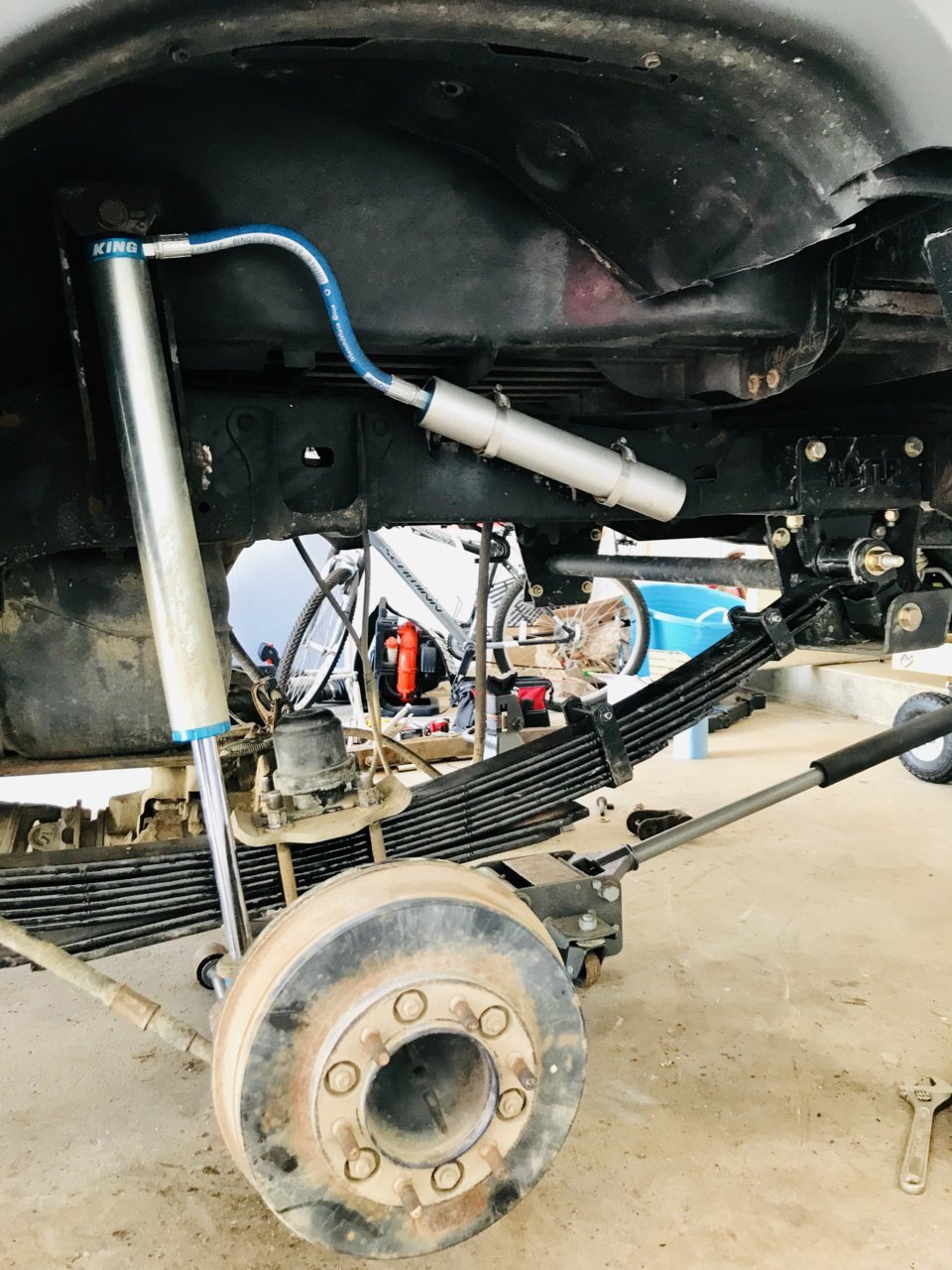

    None of our opinions will be very helpful without knowing the actual weight of your truck with whatever load you typically carry. Get it weighed at your dump facility or a trucking company. Weigh it with front wheels on the scale only, full truck, and rear wheels on the scale only. Then call Deaver at (714) 542-3703 and get their recommendation based on your weight and needs. They are the experts.
    My U402's took 7 weeks from April 29th to deliver, but they are worth the wait. Stage 1 is perfect for my truck at about 2,400lbs rear weight.
    Deaver U402 leaf packs are going to be about double the lift of the procomp AAL, so prepare for that. Deaver can make you a custom pack if you want.
    Don't buy anything but Deavers (or possibly Icons or Dobison, but I haven't used those) unless you hate money.
