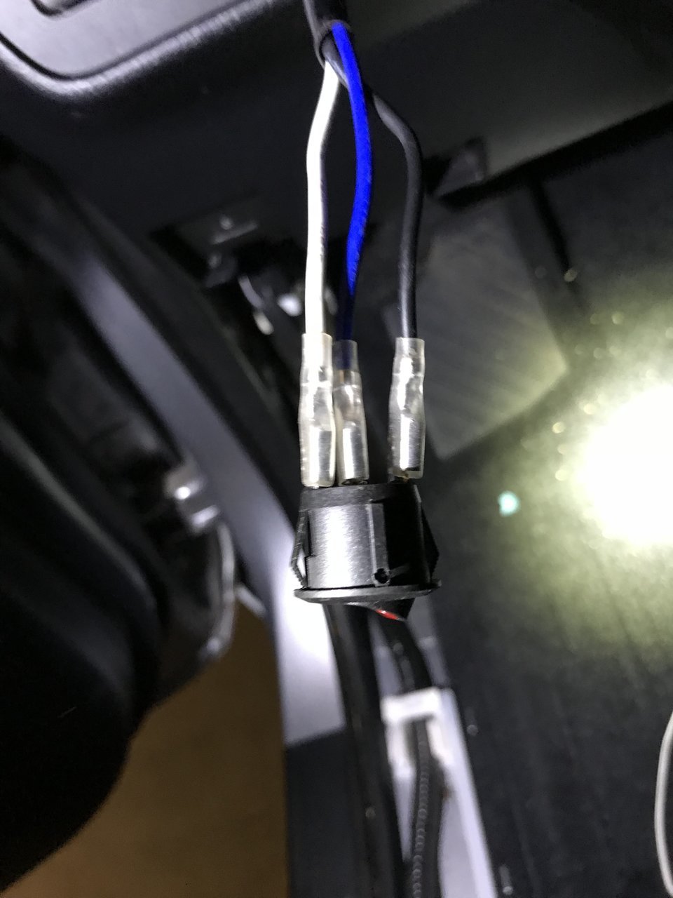

    I am currently wiring my ditch lights from Cali Raised and am having an issue. I have all of the wires run and am connecting to the basic switch they provided. The three wires (Black, White, Blue) came detached from the switch and I am currently trying combinations to get the switch to work. My problem is no matter which order I put them in the lights come on when I attach the battery cables, and the switch won't turn the lights off. I attached pictures but am looking for help. TIAIMG_1288.jpgIMG_6859.jpg

    I can't make out what you have connected to the battery. But until you figure out the wiring only use 2 wires and not 3.
    You should have battery + -> switch -> light -> battery negative or ground. So play with the 2 wires on the switch, one to battery, and one to lights.
    If the led in the switch comes on without the light you have it wrong. ( you are powering the light through the led). Once you have it working with the led not litup then you can connect the 3rd terminal wire to ground.
    If you cave a continuity tester, then just put that on the switch to work out the terminals.

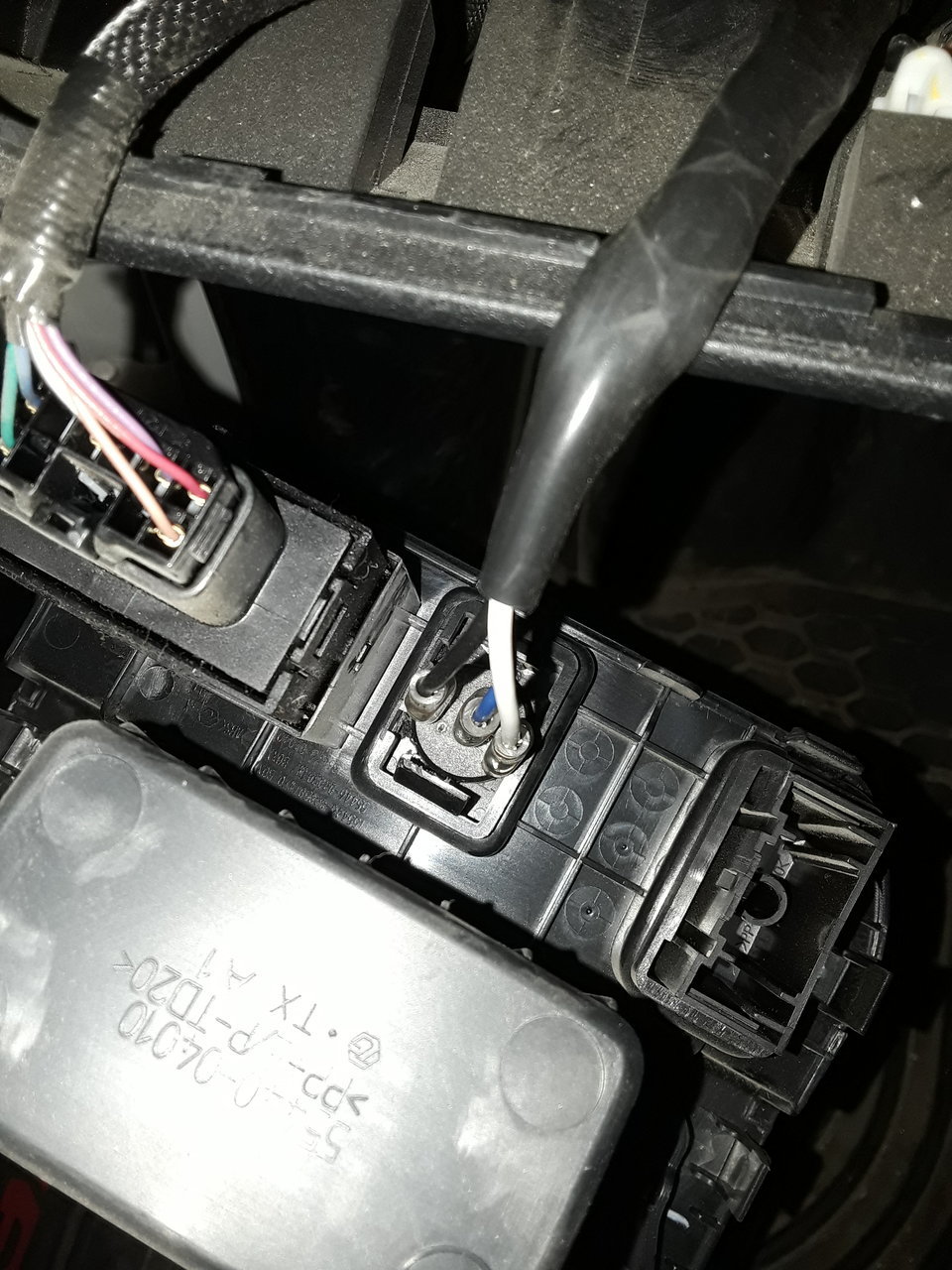

    Give me a minute and I will go look at my switch and take a pic for you

  16. Nov 2, 2017 at 9:40 PM

    Ok This is the same wiring I have in my OP right? And then you have the Black and Red wires connected to the black and red battery terminals? When I have everything set up this way the lights go on without any input from the switch. I can call CaliRaised tomorrow, I was just hoping it would be a simple fix that I overlooked.

    Red wire goes to positive on battery, black wire connects to the ground on the body (follow the black wire off of the battery).
    Run black, blue, white wires into the cab for the provide switch. Blue goes to the center, black and white on either side. Should be that simple. Wires on the left of the pic ate not the ditch lights

    Ok I have been connecting the red to positive and black to negative so this might be my problem. On the Cali video they show the black going to the negative battery terminal and not to the ground on the body.

    I think they also used a different switch. The oem ditch light switch has 4 wires I believe not 3
