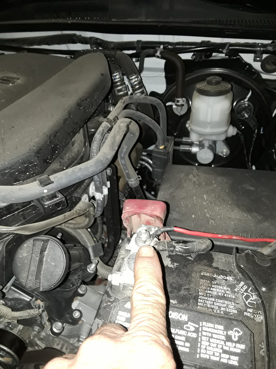

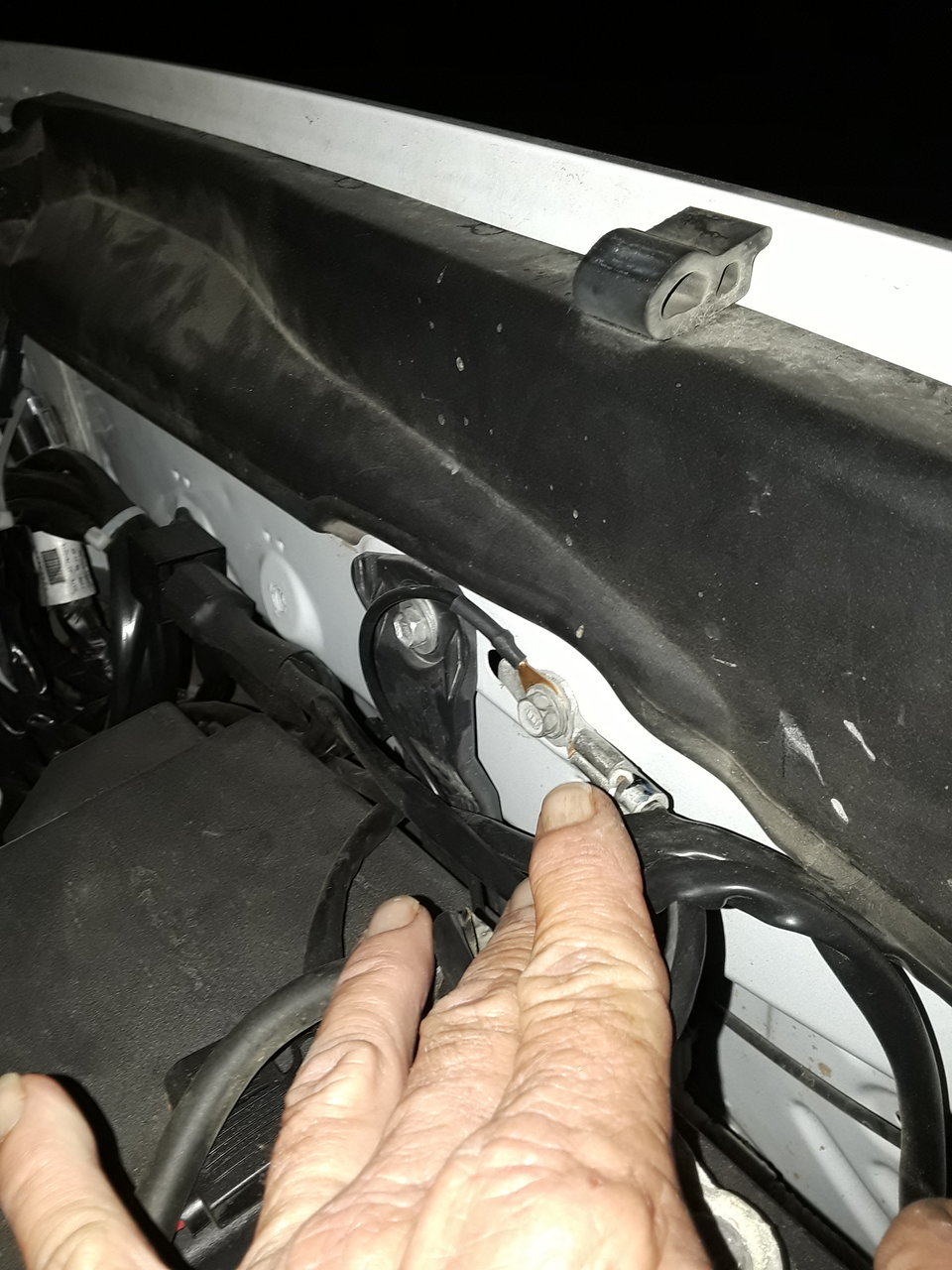

    41,570
    I suggest hooking that ground on the body or the positive on the battery last. Or at least have that switch wired up. My wires touched and I blew the fuse. It's 30 amp fuse

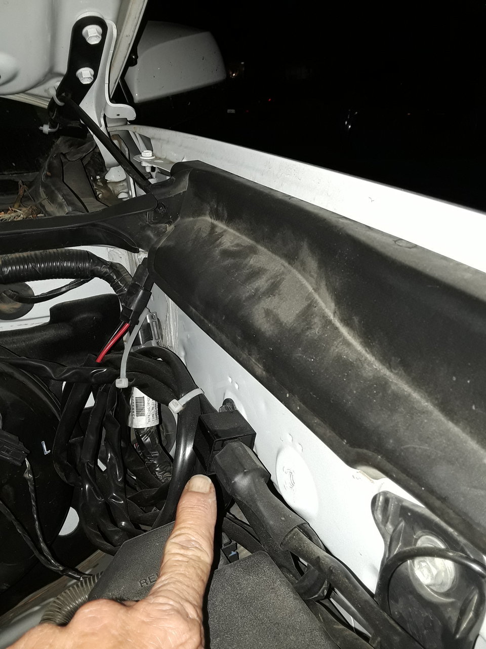

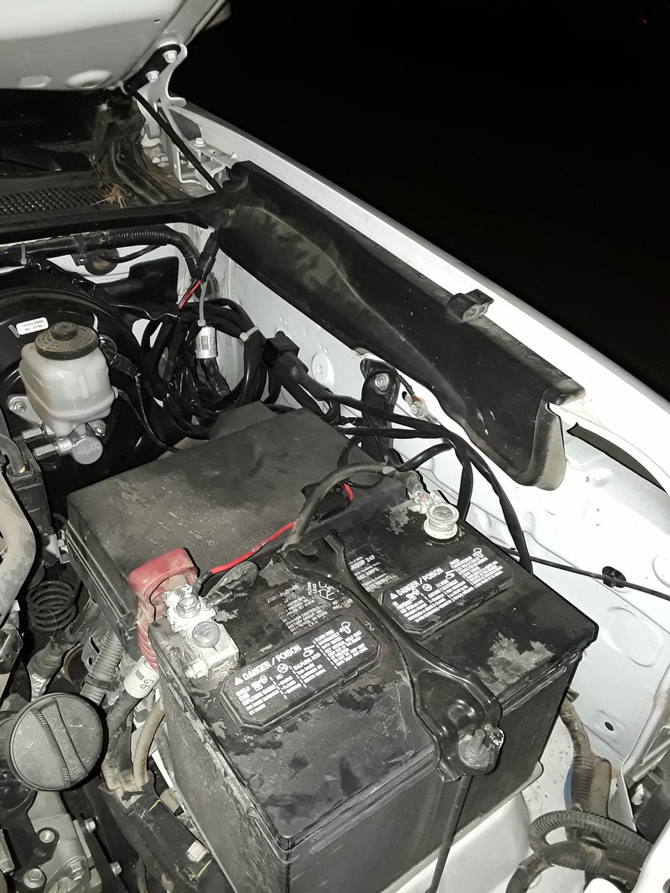

    Ok here you go in order
    1 Positive
    2 Negative
    3 Relay
    4 full view no fingers
