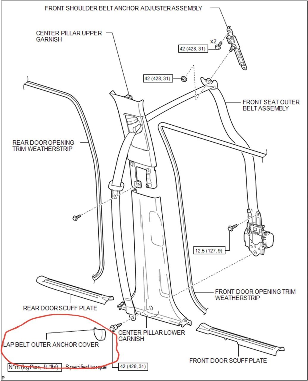

    My 2020 vibrates on the front passenger side of the cabin as well. I narrowed it down to the front passenger seatbelt anchor cover located on the bottom. The cover rattles when going over bumps.
