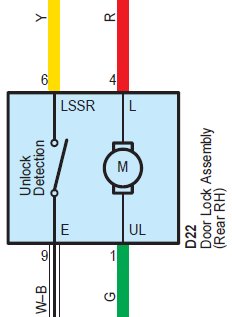

    Everything you describe tells me the plunger sensor on the door seal might be defective or otherwise not connected.

    My money is on the unlock door detection.
