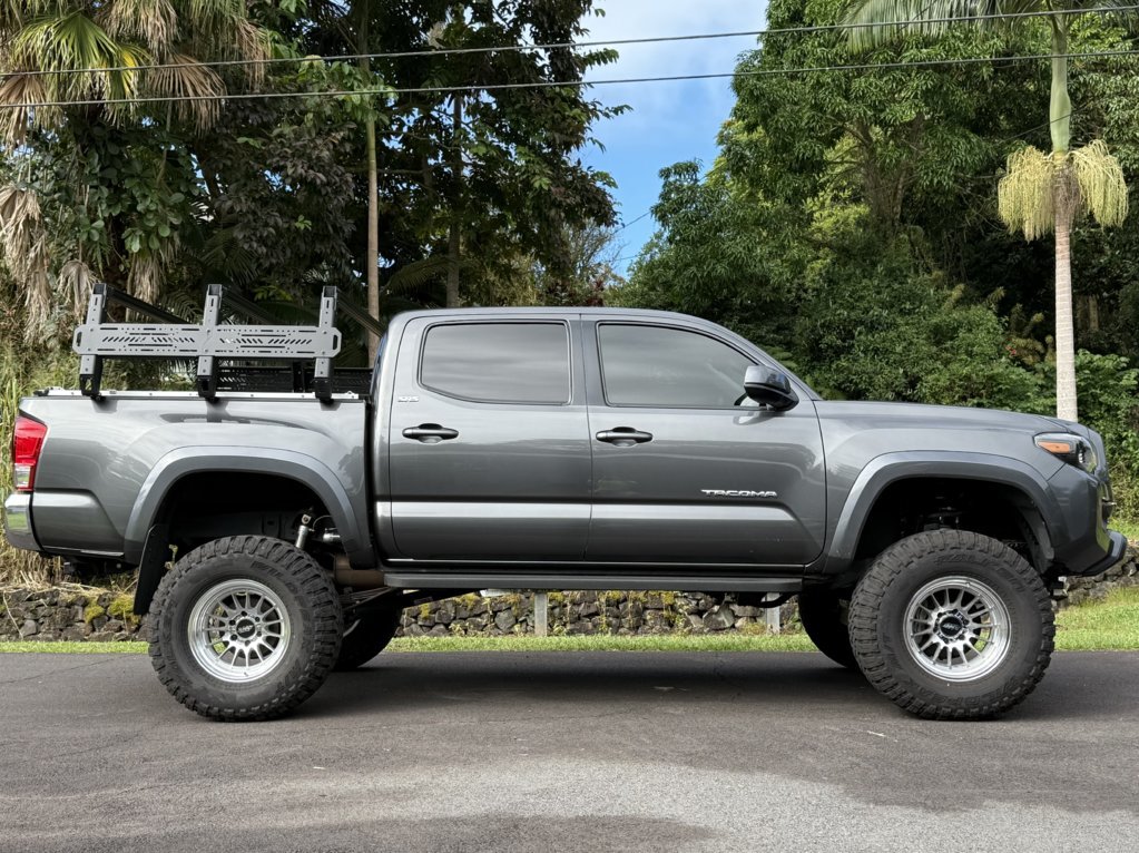

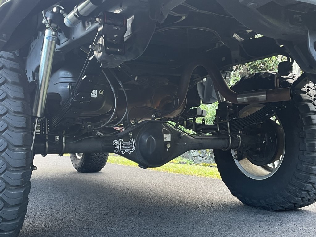

    Pro Comp 6", full length 5100's with OME 888 w/ taco lean spacer, 5160s w/ Alcan custom pack, HS extended brake lines, Summit offroad Dakar 17x9, 315/70/17 Falken Wildpeak MT, Nitro 4.88 regear
    Custom Alcan 6” 600lb spring.
    It’s NOT my daily, although I do drive it empty bed majority of its use. It’s stiff, but still rides better than my lowered Mach 1 on H&R springs with Koni yellows
    Although, once there’s ANY weight in the back, this truck rides stupid smooth. Smoother than factory (using 5160s for shocks in the rear)

    What brand overland rack is that in the first pic and is it tonneau compatible (can you still open the cover with the rack on)?

    Are you using Tacoma 5160s or something else? With those springs seems like you would be riding around with shocks fully extended making it harsher than it should be. Also I would think you wouldnt be able to compress them all the way. Extended length 5100s or 5125s or something from another vehicle (Tundra 5160s maybe) seem like a better fit. Maybe thats what you have?

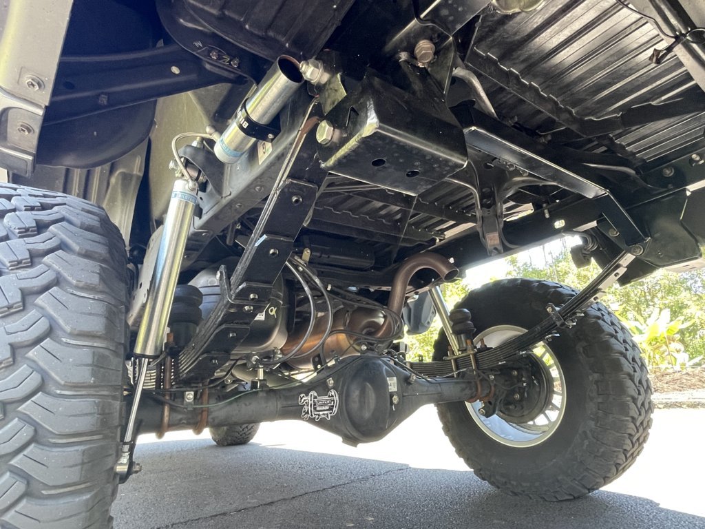

    I went with 2" lift over stock at 1,300 lbs. of capacity. They also ask you how you plan to use your truck and tailor make the leafs for that type of driving.
    Installed at ~9,000 miles, now at ~34,000 miles, loaded with a camper the entire time. No degradation in performance or lift.
    [​IMG]Rear Towers plus Misc. by Michael Rickerd, on Flickr
    I have several other upgrades done to the rear, but these leafs are absolutely incredible. As empty as I can easily get, all the way to fully packed with ~45 gallons of liquid on board, they ride the same. From paved roads to the Devils Racetrack, they simply just work.

    Nice. How far out did you have to space the rear tires in order to keep from rubbing on the shocks with the rear towers? Trying to keep my truck from getting too wide since there seem to be a lot of really narrow spots around here.

    1.25" Spidertrax spacers, though I still do rub the shock body in the most extreme situations. My rear end is very droopy, the small bundle of wiring at the third member from the underside of the bed is unclipped both top and bottom and it still straightens out a good bit when I have the rear flexed.

    Uptop Overland
    Mines a softtopper rack, it’s been a minute but I think they have a tonneau cover one. I think

    Idk. I just measured my truck, and bought the measurement extended/collapsed I needed. Also had to buy the stem conversion adapter.

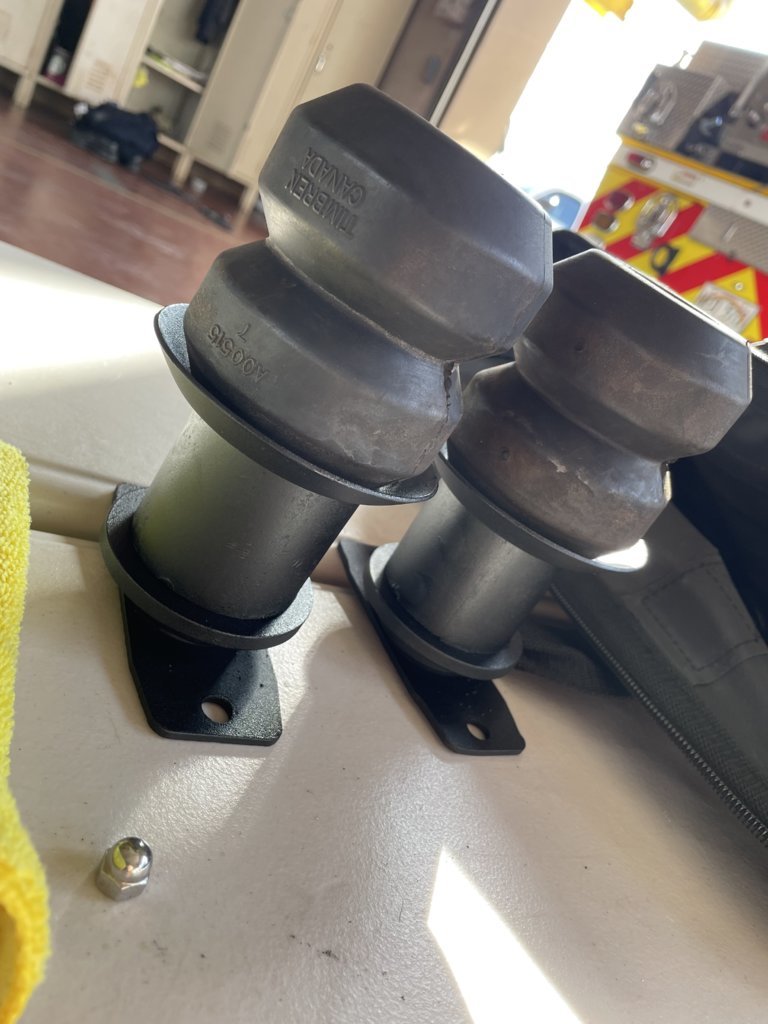

    Extended my timbrens to match it up so it doesn’t completely bottom. You never want it to bottom. IIRC, I think I had it 2” from fully collapsed, accounting for the timbrens to compress a tad. Never had an issue
    Trust me, it ain’t fully extended. I have a lot of downtravel, had to really extended my brake lines lol

    So the universal application shocks, I think they call them 5165s or something like that. That makes more sense. Sounds like you did it right.
