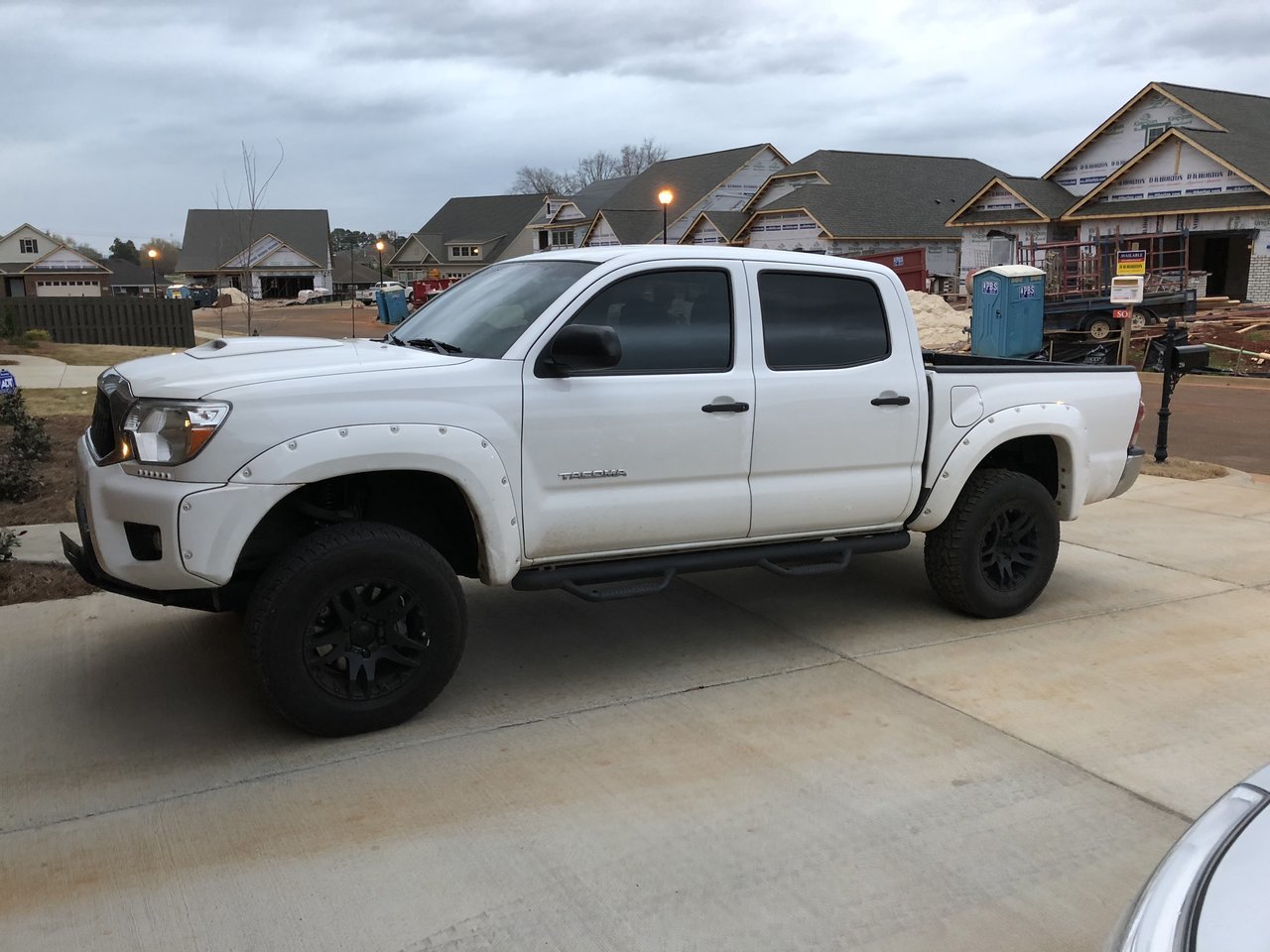

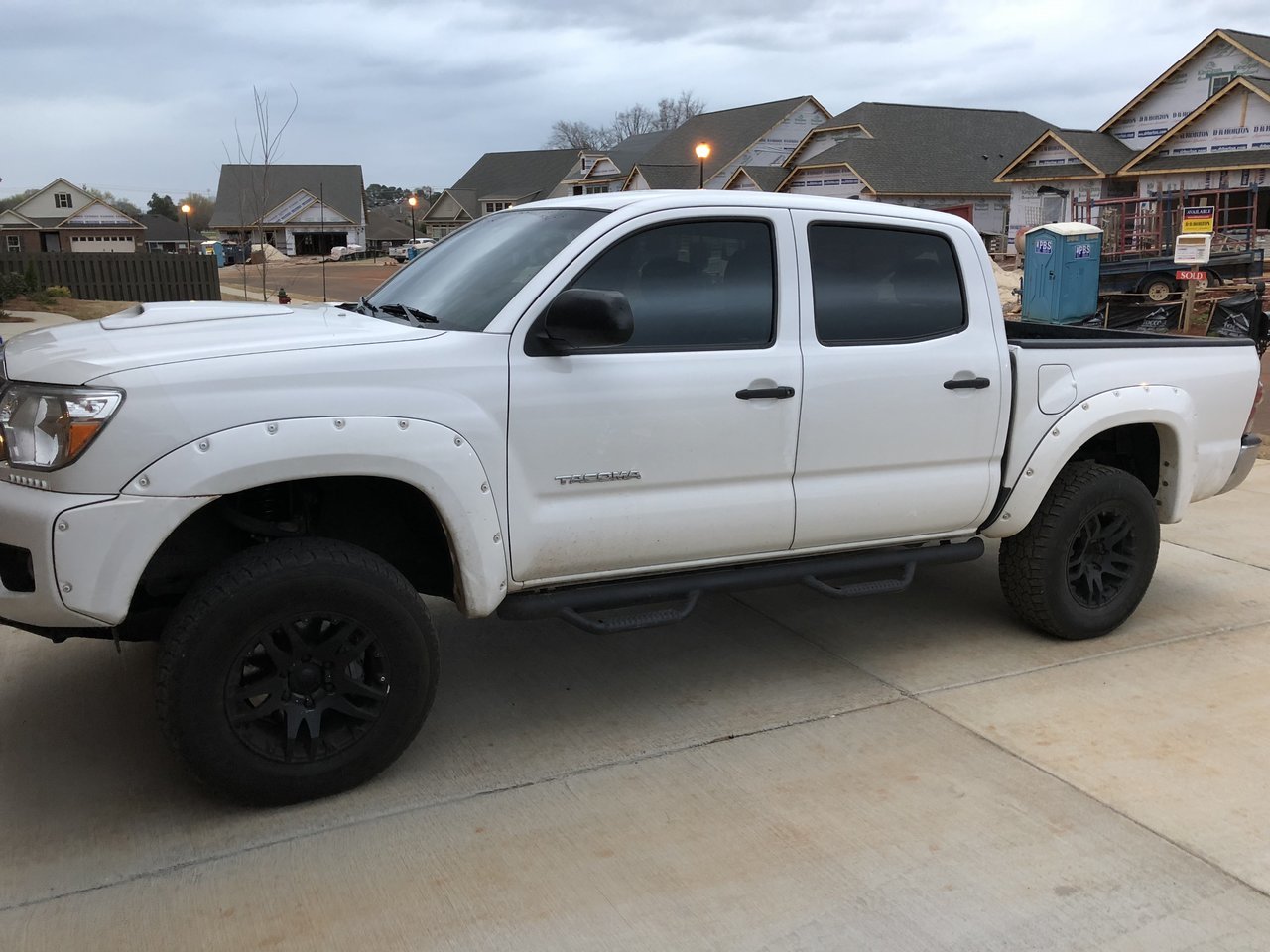

  5. Mar 25, 2018 at 5:41 PM
    DuttonCD
    DuttonCD [OP] Well-Known Member
    Jul 1, 2016
    #190981
    326
    Alabama
    2018 TRD OR CEMENT
  6. Mar 25, 2018 at 5:42 PM
    DuttonCD
    Jul 1, 2016
    #190981
    326
    Alabama
    2018 TRD OR CEMENT
    693F0D2F-323E-4730-91A3-8A7EEDC4D12A.jpg23” from center hub to fender all four corners.
  7. Mar 25, 2018 at 5:43 PM
    EricL
    EricL Tomahawk Chopper
    Aug 21, 2014
    #136643
    16,012
    Greenwood, SC
    2015 Slowmobile
    SOS Offroad Concepts Armor
    That allen got me and the guy helping me when we did mine, too. :)
  8. Mar 25, 2018 at 5:48 PM
    boogie3478
    boogie3478 Well-Known Member
    Oct 12, 2014
    #140179
    26,396
    14 TRD Off-Road V6
    All the mods
    Looking good. How's the ride?
