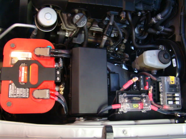

    I have a D34/78 Yellow Top with sideposts. The posts are opposite from the factory battery. The factory positive cable was long enough to extend to the sidepost but I had to buy a longer negative cable that was long enough to reach.
    I use the top posts for my amp and added fuse block.

    Here's another picture of when I had the Red Top, same battery size as the Yellow Top I have now.
