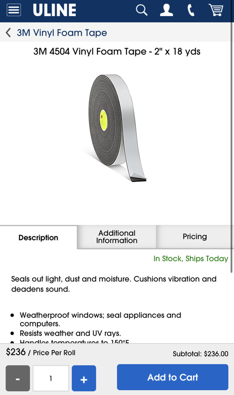

    I'm not finding something specifically like that, but I found some neoprene weather stripping. Too stiff?
    https://www.amazon.com/Density-Waterproof-Neoprene-Single-Sided-Adhesive/dp/B07QPN5W7Q/
  15. Aug 13, 2021 at 5:19 PM
    #35
    MNMLST
    MNMLST Well-Known Member
    Aug 22, 2017
    #227659
    1,891
    Earth
    tinfoil lined cab runflat headlights pee-thru seats
  16. Aug 13, 2021 at 5:21 PM
    #36
    phdog
    phdog [OP] Well-Known Member
    Jun 27, 2017
    #222534
    1,269
    Jim
    Northern Colorado
    2017 TRD Off Road
    w/Super Terrific Happy Hour Mod
    Thanks, but $236? Granted, that's about 30' more than I need :)
    MNMLST[QUOTED] likes this.
  17. Aug 13, 2021 at 5:26 PM
    #37
    MNMLST
    Aug 22, 2017
    #227659
    1,891
    Earth
    you can find it in smaller rolls, but that’s the stuff
