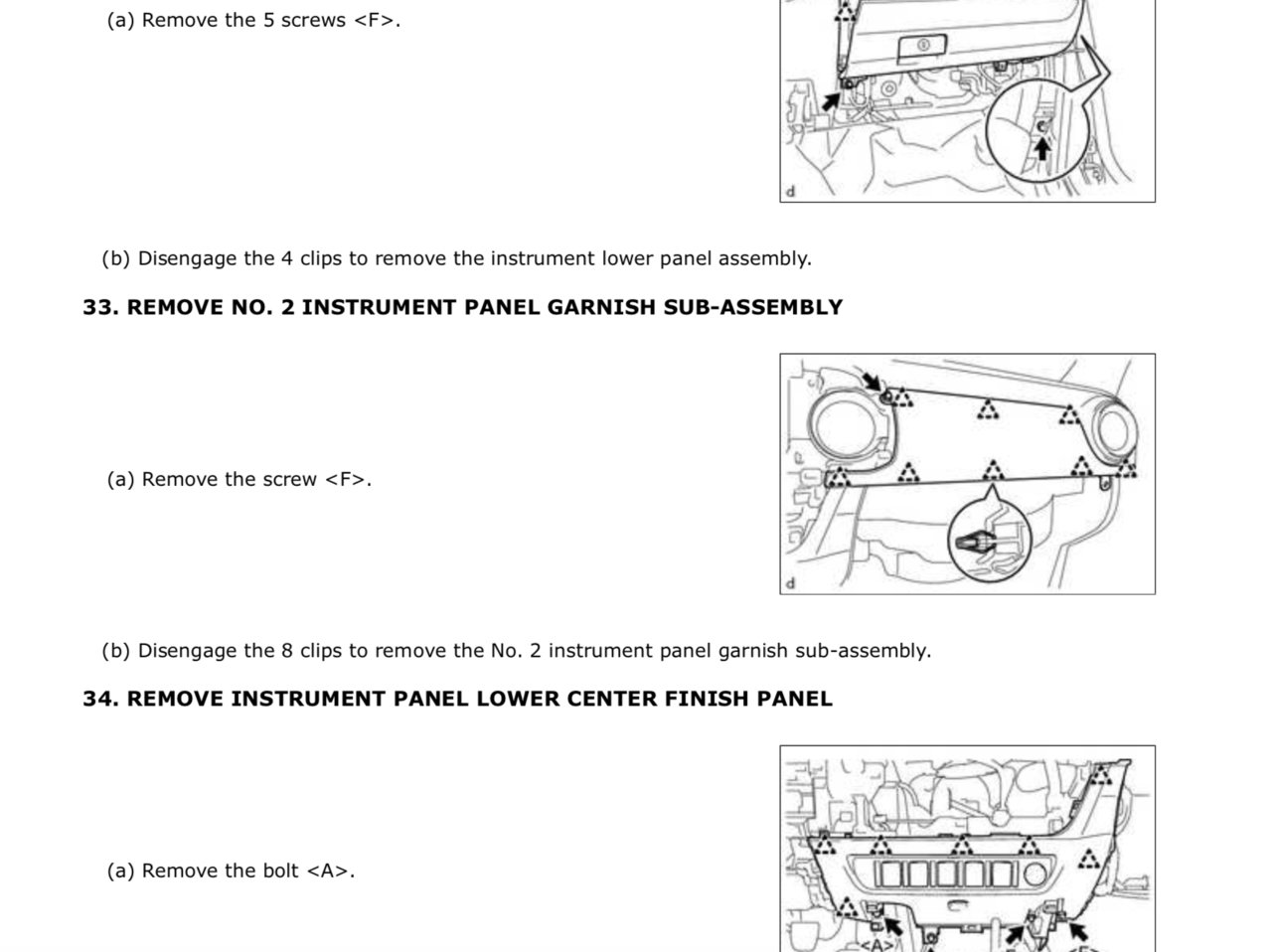

    Are you sure I have to remove any parts other than the radio surround that pops right off? I found this in the service manual and it looks like there's only 1 screw and than 8 clips to "disengage" which I assume means just pull off with some force. But if what you're saying is true maybe there's some of it hidden beneath the other plastic parts so it wont pull off without removing more?

    You think there's any chance it just pops right off itself after removing the screw behind the radio surround?

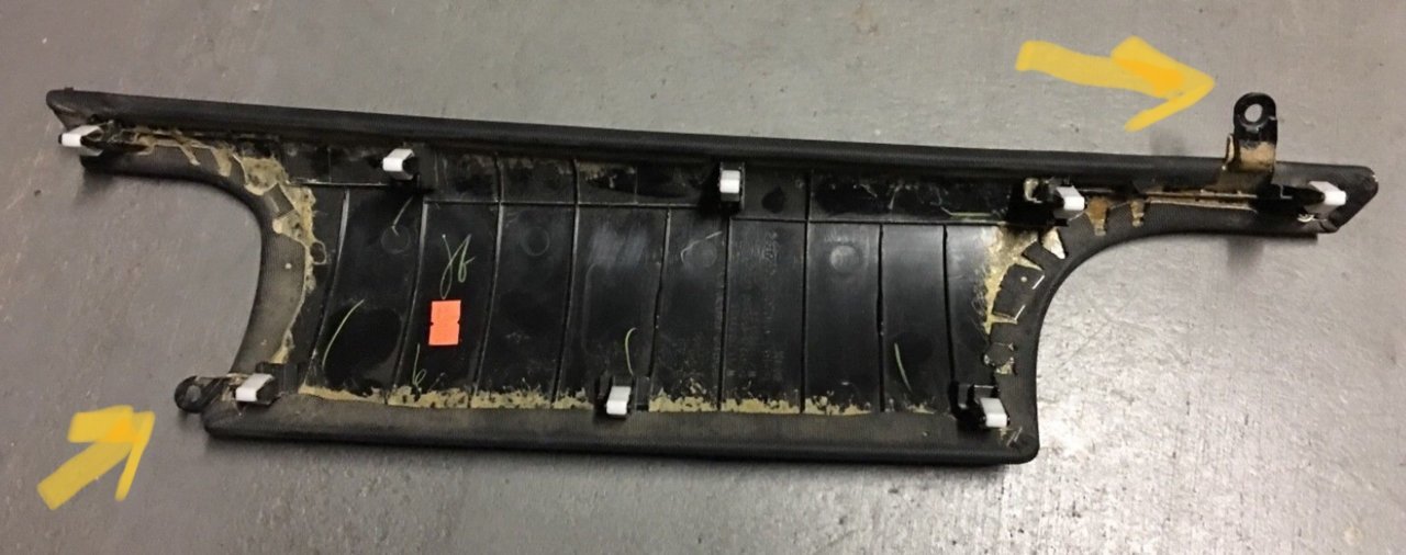

    I realized I was thinking of this thread on removing center console cubby area - HERE
    However it still sticks out in my head from the pictures:
