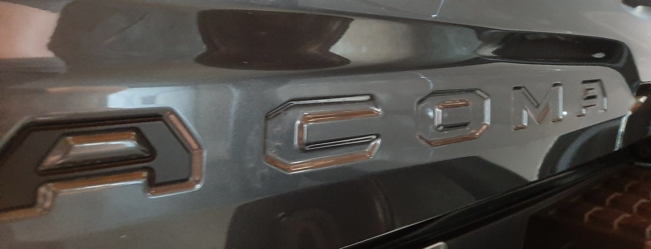

    If you're really crazy like me, you put on the black, don't like them, take em off , paint em, put em back on.
