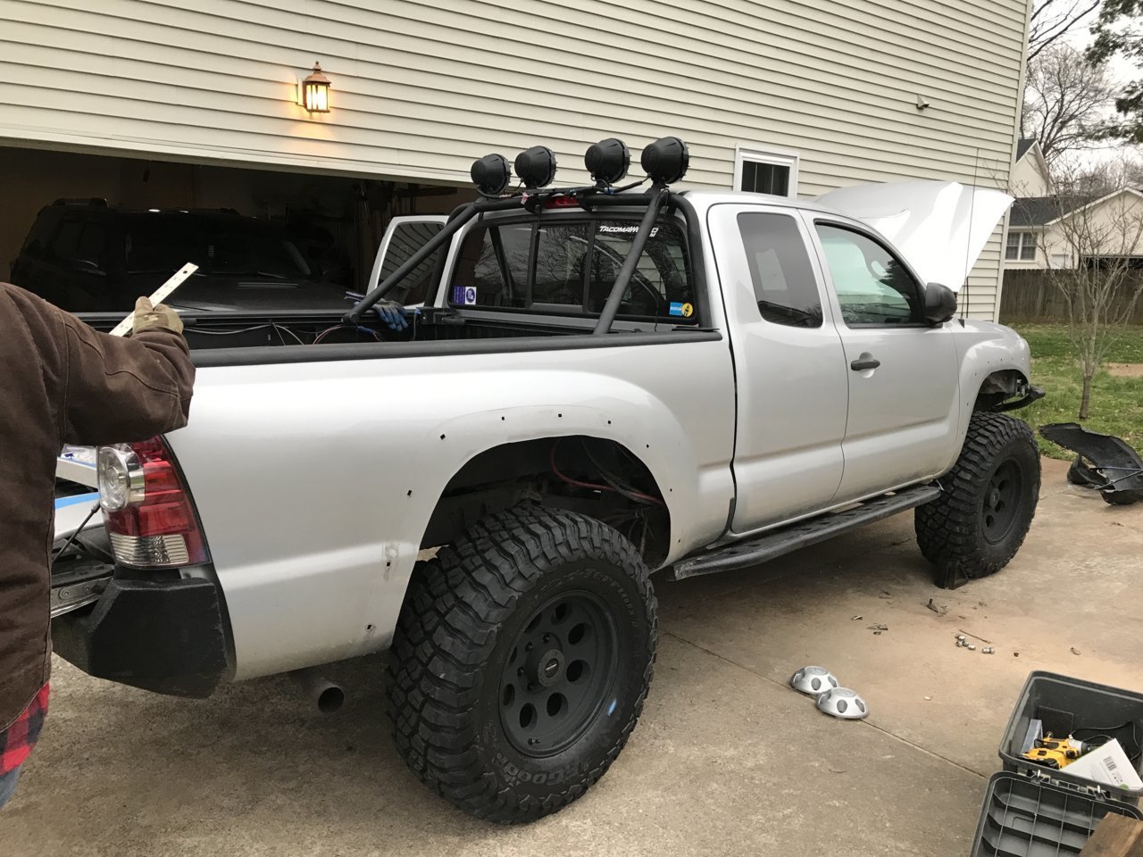

    I still have that rounded bolt and I'm still using the mounts you there together haha. I'd taken it off and rewired it with KC ProSport HIDs in I think 8", but the mounts worked so well I've never felt the need to do anything different.
    Totally agree about building the mounts. It's easy and likely to be much stronger than whatever was provided. I'm also mostly certain it was the 1" flat stock from HD that we used.
    And of course a pic of mine because I love it:

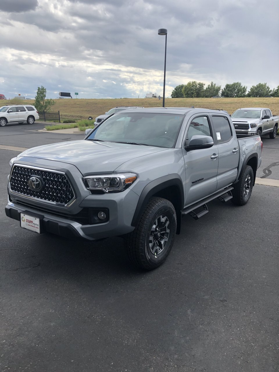

    @MikeyMcFly do you have a link for that roll bar? I just picked up my Cement gray TRD OR after totaling my SR... night a day difference in trucks but have always been in search of a classic “Back to the Future” looking bar. 47925803-262B-42CC-B66A-5CF7DF8E25B3.jpg96BFD798-E9EB-4CEB-849C-A449855F0727.jpg
