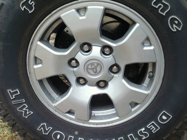

    Holy cow what a difference. No more brake noise! No more shimmy in steering wheel when braking.
    Also, my brake pedal used to go down an unnatural distance (like half way) before braking occured, now the pedal goes a very short distance before they start to work. Brakes feel like the wife's 4Runner now. Night and day difference from before.
    As far as the pedal distance maybe the new rotors are wider or maybe the pad are just thicker but they engage perfectly now.
    I think I am more excited about the new brakes then I was when the lift went in lol.
    BTW the screws popped the old rotors off with ease. The bolt size ended up being M8-1.25 x 30
    As a perk the drilled/slotted rotors look bad ass sitting behind the rims. Ok, maybe not bad ass but pretty cool atleast.
    Now let's see how long they last.
