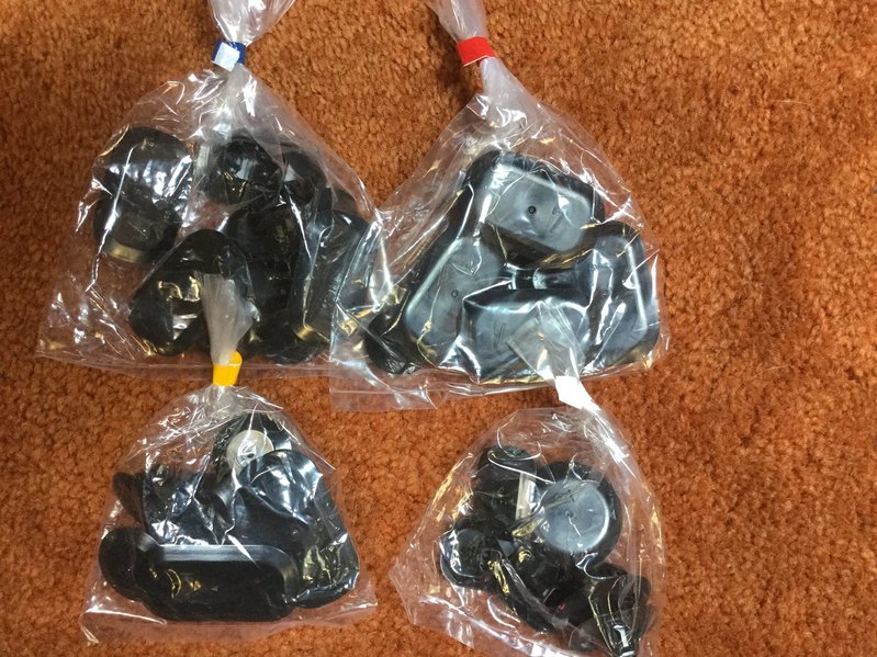

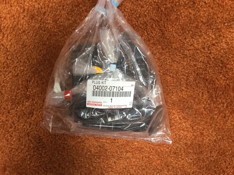

    Use the Toyota frame plug kit after the fluid film application.

    hi mad man marty,do you have a part # or a way for me to find these plugs?.sounds like a good idea. thanks for the tip.

    Local Toyota dealer.parts dept. will know what it is.

    perfect!.your the man marty. thanks a bunch!!

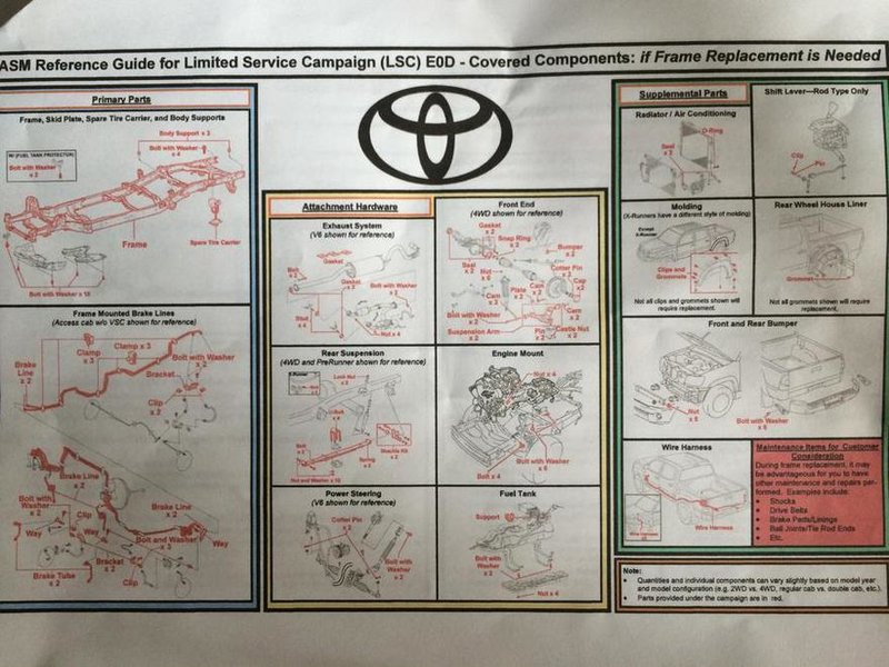

    Is there a diagram available that illustrates where all of those various plugs are used?

    Do a search for this. It has the plugs listed & install locations.
