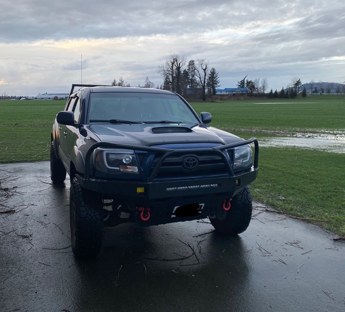

    I've still got the OEM suspension on my truck and its at the point where everything squeaks but I don't want to fix it because I know I want to lift it anyways. So I've decided now's the time.
    I have been looking for a while on where to look and buy but for some reason it doesn't seem like they make it easy. I am wanting a 3'' lift with an add a leaf on the back instead of a full new set. Seems to be difficult to find.
    Suggestions or places to look would be great :)
    Obligatory photo of my truck

    Your truck looks like it's already lifted in the front. Are you sure it's stock?

    When I bought it a couple years back the guy told me he had a 3/4 inch lift on the front. OEM shocks on the front and back and no indication of spacers either. I do have just about 33'' tires on it though

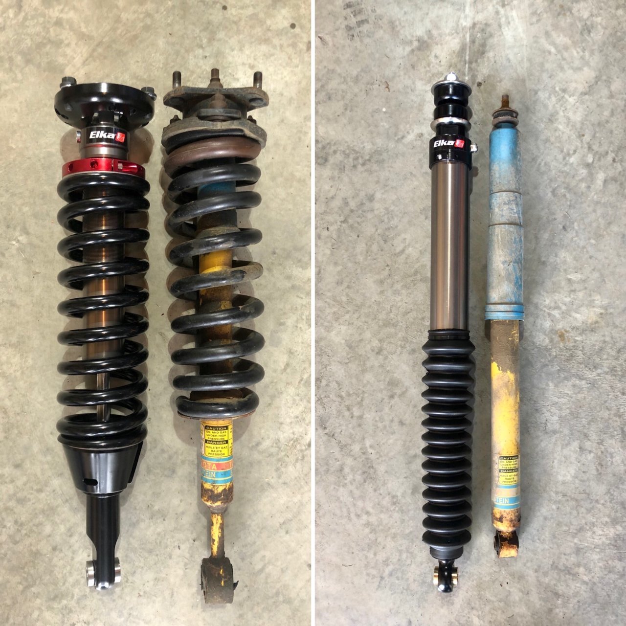

    Lots of guys up here in Canada are starting to run Elka lifts. They are great against our harsh weather and salt.
    I recently put on Elka 2.0s with 2-3" lift. I paired them with SPC upper control arms.
    That is in your price range and is a great setup.
    I used to run a block lift and I would NEVER recommend it!
