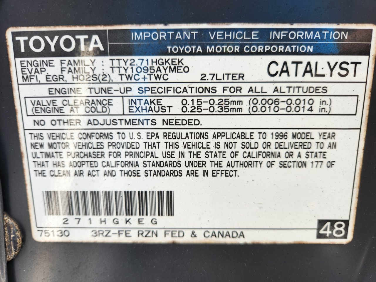

    I was looking at plugs on Rock Auto and it showed a few with different preset gaps, thought I would have found this info on this label but that's a no go.
    I have a gap gauge tool to make sure of the correct spec but I don't know what the spec should be?
    Thanks for the help!

    It’s not in the user manual?

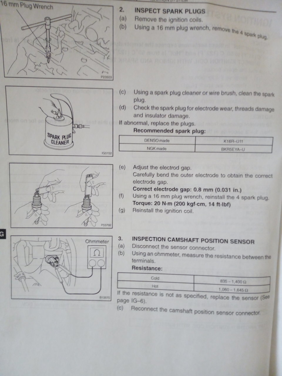

    Google says 0.031"

    Didn't come with one when I bought it.

    Also note Denso or NGK #'s.
    Don't buy random bosch or autolites.

    Yeah I was reading on some of the past posts on here. Probably go with the Denso plugs.
