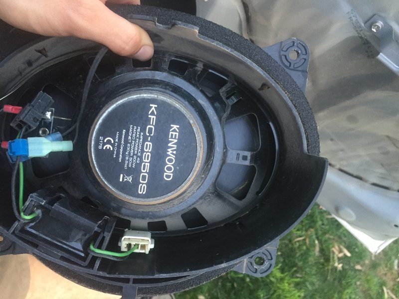

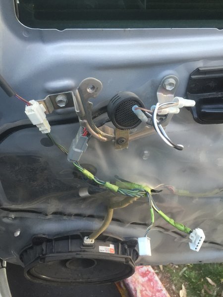

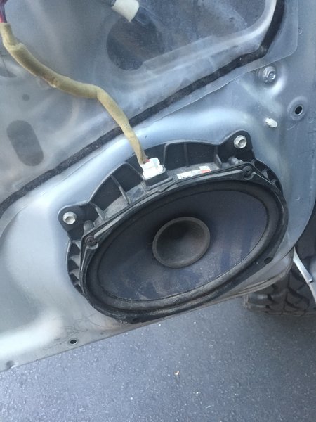

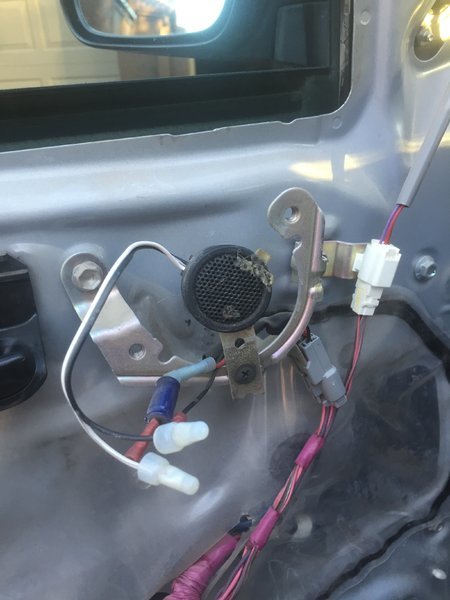

    So I opened the door panels and this is what I found....where is the crossover??? What's the deal with the resistor on drivers side only?

    THIS
    Your PO added some shitty and unnecessary tweeters to an already full range 6x9 speaker. The resistor is a feeble attempt at a crossover. You said you were going to replace everything anyway so why not completely start over and replace all the speaker wires from doors to HU. Your choices for front door speakers are either a 6.5" component set with a separate tweeter and proper crossover, or replace those current ones with a decent set of 2 or 3 way 6x9's and forget about the separate tweeter. The rear doors will be fine with a set of 6.5" coaxials.

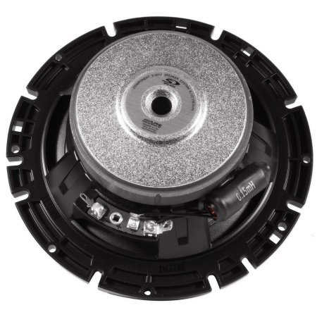

    I keep getting mixed feedback on whether I will need a crossover with those alpines? Someone said I need a resistor too?...it would be nice to just plug the tweeter into the woofer instead of wiring crossovers

    Those have an inline filter. As far as i recall you will run the main (+)(-) to the woofer and then theres a second set of terminals to connect the tweeter wires to.

    Not sure why they say ya need a resistor, thats news to me and i installed car audio/video for a while on all sorts of cars.
    The black heat shrunk section of the tweeter wires has everything needed for the tweeter to prevent low frequencies.
    To mount the tweeter you can cut a bracket to fit the tweeter out of 1/4 mdf or whatever the thin size is to mount to the factory tweeter bracket mounts and flush mount it using the threaded rings (pictured lower right above the screws) and then bolt it in place.

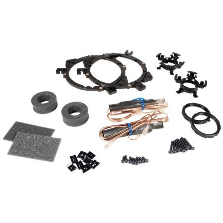

    Id like to just buy the proper mounts....they say 1" tweeter. Do I need 1" tweeter mounts ?

    Yes. Mr Marv sells them. I used a set when I added my tweets and love em.

    Probably something like 1 3/16". It shoud list the cut out specs for the flush mount tweeter option

    Trust me, pay Marv the $20 or so and save yourself the headaches.
