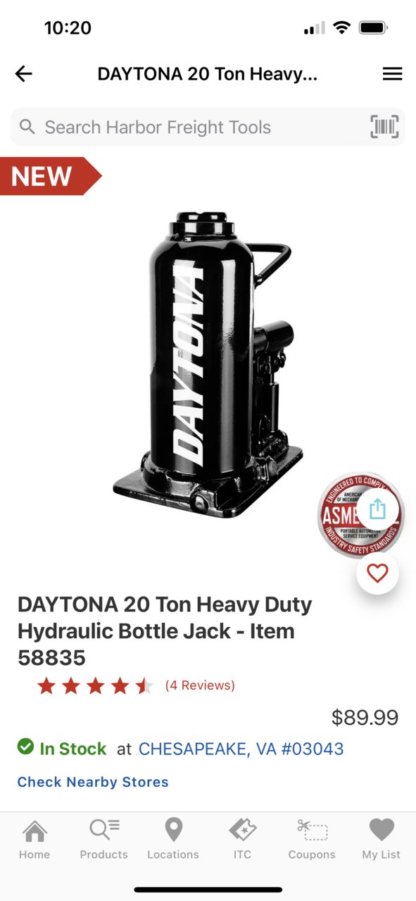

    OP, just discovered this option while perusing harbor freight. It has almost three more inches lift height than it’s Pittsburgh equivalent, up to 20”. That’s plenty for working on our trucks.
