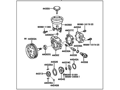

    I'll see what I can find
    here's a 99 pump....not if yours same
