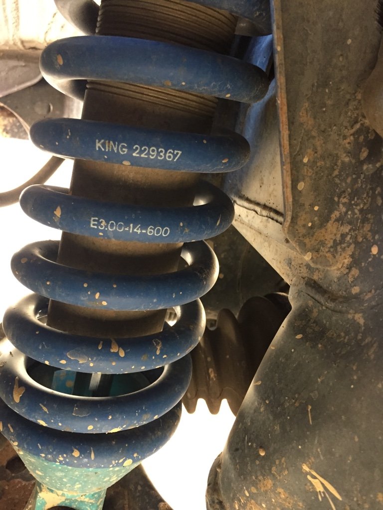

    They are cranked down less than I thought. About 3/4".
    Springs are shown in picture below.
    Also the truck still doesn't sit quite level.
    Does King sell slightly longer springs?

    I have a set of Kings ext with close to 2" of thread showing on top of the adjuster for about 3" of lift and my truck rides nice and smooth. With the little amount of preload set on yours should ride real soft. Maybe you are getting most of the rough ride from the rear springs or maybe time for a rebuild on the Kings with some different valving.

    Wow, 2"?
    Are yours maybe a longer version? Do you know which weight spring is on yours?

    Yes they are the extended ones but think they have the 600lb coils like yours they are only a year old too. Didn't have any special valving done just off the shelf whatever they come with.Have Allpro off road 3" rear springs with a couple leafs removed and bilstein 5100 and the truck sets pretty level and rides pretty good. Rides a little firmer than it did all stock but think that is mostly from the E rated MTR's
