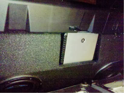

    My set up is pretty much the same as the one on my profile I just redesigned the amp rack and made the box a tad bit bigger than I should have but if u are asking bout the spot welds then I'm sorry I can't really show that everything is bolted down in my truck now and yes I can fold my seats down
